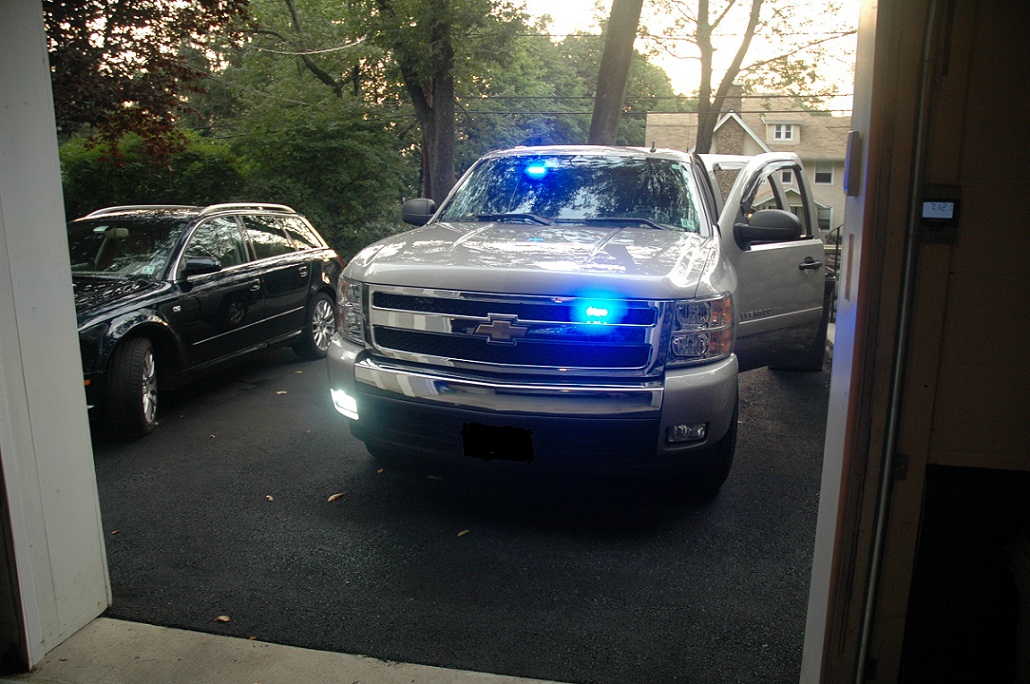

For those interested heres the setup i got on my truck. Whelen Talon on the Dash, LIN4(no longer produced) in the grille, and hide aways in the fogs. My setup is a little different now but this worked great. Also got a 100 watt siren speaker in the grille.
That's a nice set up.
