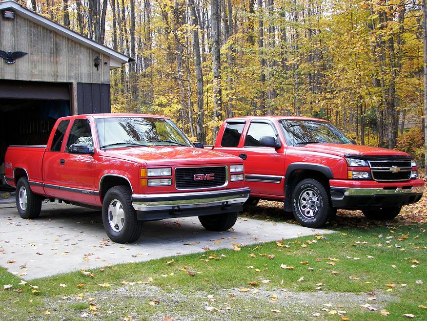

I dont know what you can do to improve you mpg's other than keep your foot off the skinny pedal, or put a 2x4 block under it. My grandpa has a 99 with the 5.7 and his old man driving gets him close to 20 just about every tank. 63mph on the highway gets him damn near run over but about 23mpg.
See pic of truck below
