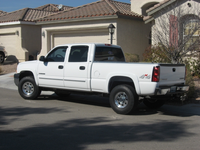

Hey fellas, i was was thinking about getting 285/75R16 Nitto Terra Grapplers for my white 04 ext silverado. I would was wondering how big of a lift i would need to fit these on my truck. Any pictures of white chevs running these tires would be greatly appreciated! thanks

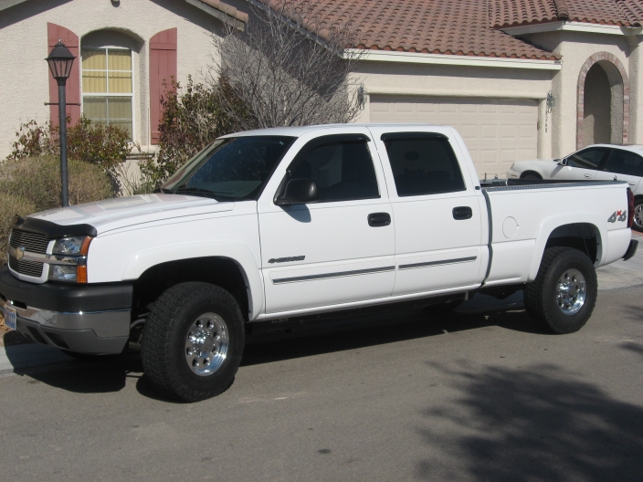

It's white, it's a Chevy, it's running the exact size/make you state...minor trimming at front valance, torsion bar lift.
thanks man. exactly what i needed to see. would u recommend them? are they noisey on highways? how well do they wear? do you like them? just a couple questions haha
I'd recommend them, so far they seem like a good tire to me, plus they come in load range E, which is what I needed. Noisey...not at all. I've only put about 3500 miles on 'em so far (in about 9 months) and they still have some ta-ta's on them, so...

And yeah...Crank the bars a tad and take a hacksaw to the lower valance and they clear fine. That's the size I had on my '02 (they cleared without trimming the valance on the stock rims).
