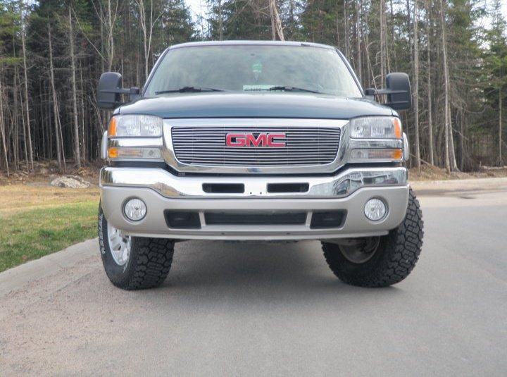

Ive got an 07 classic sierra with a levelling kit installed, running 33 11.5 R17 Dick Cepeks, Ive had it in now for quite awhile and have been amazed with the difference in ride. I had the alignment all done and replaced two bad front wheel bearings AND CV's less than 5k ago. I had a bit of brake drag on the passenger side but its all been fixed since so its basically a new front end up there. However when in 4wd low and high when my steering is maxed out a metallic noise is coming from what seems to be the front end. Any ball park ideas on what I could be looking at?
