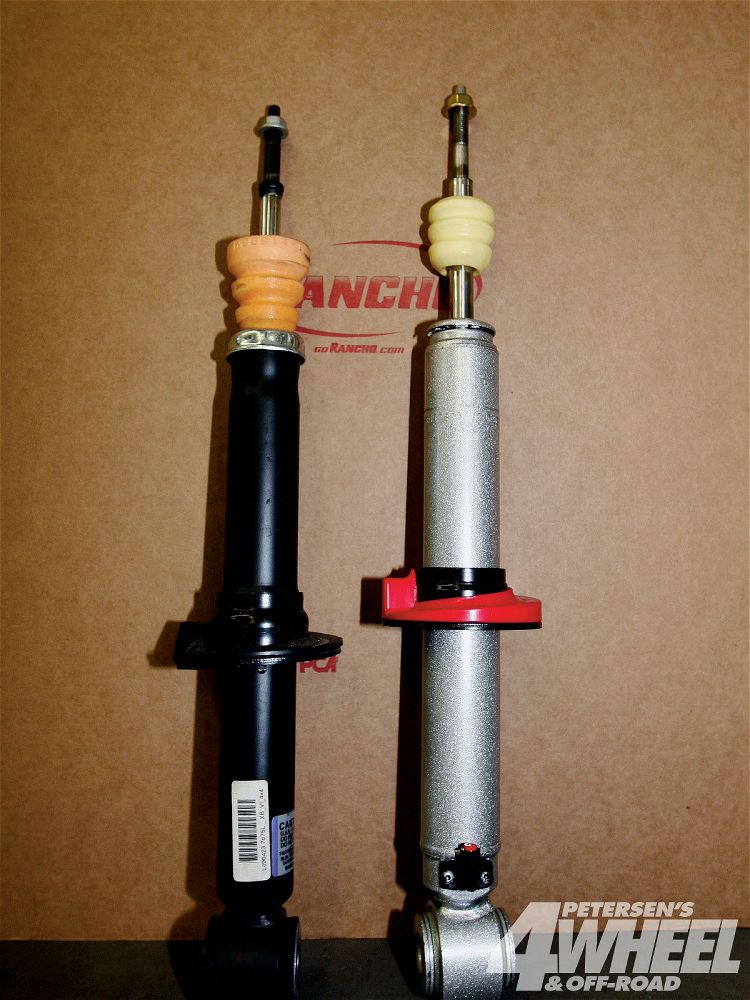

'The Rancho Quicklift coilover shock has a raised coil mount when compared to the factory shock. This in effect pushes the A-arms down to raise the vehicle and clear larger tires while keeping the stock spring rates and wheel travel.'
This picture is from 4Wheel & off road. Granted it is from a ford f-150 but it looks to me like the actual shock body is the same length, just a higher coil spring mounting plate, therefore, just pre-loading the spring to achieve lift.
That said, I am also considering this set up, and with the adjustablity of the 9000 system, I would think you may be able to adjust and compensate for the harsher ride of the preloaded springs
