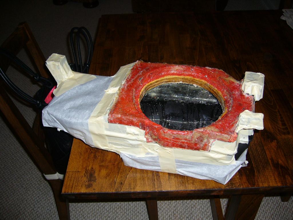

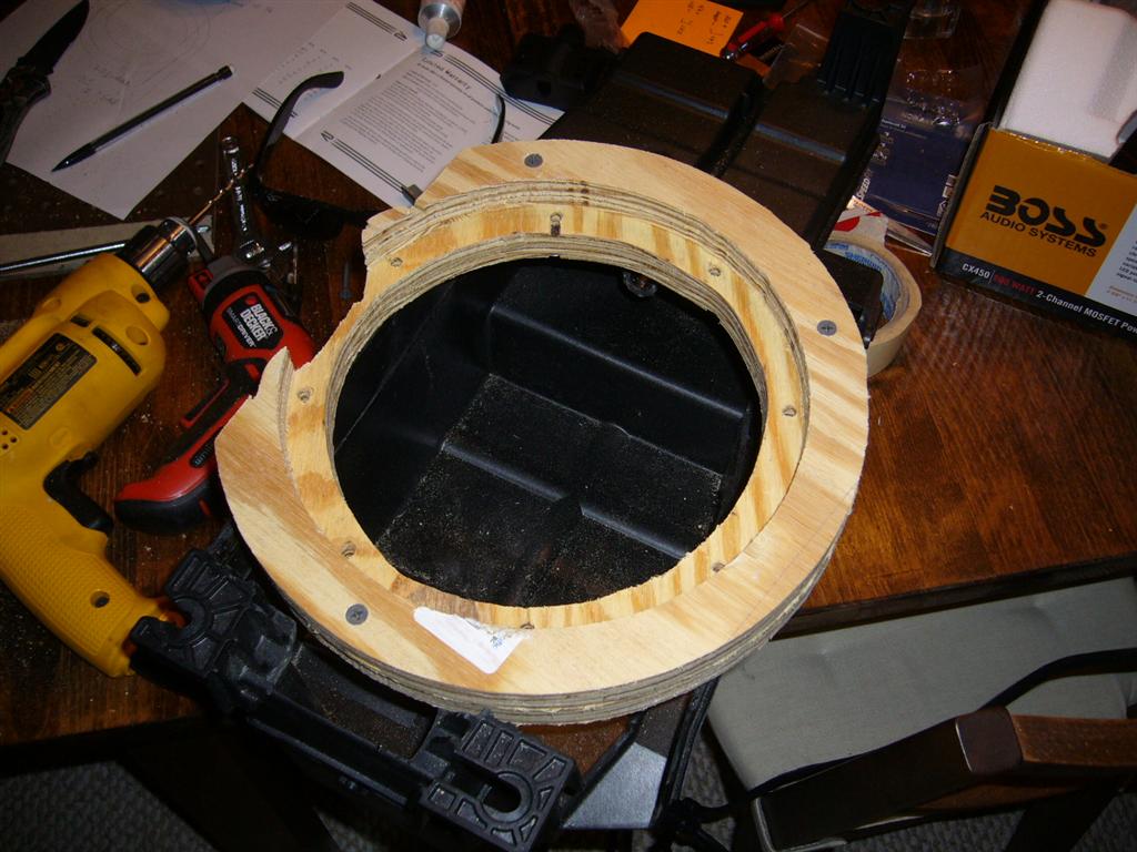

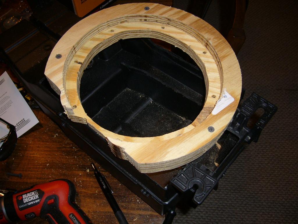

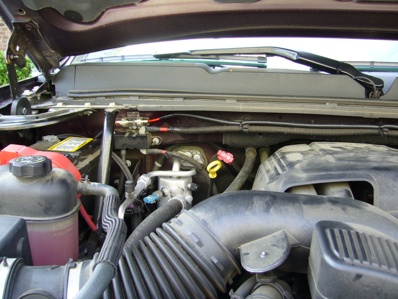

On Thursday: The amp is all wired up and I finally got the fuse holder all mounted up. I also got the box all cut up. I also cut out a piece of ply wood...so this is where the box is tonight. I decided this weekend that I don't like it. I am going to cut out some rings tomorrow and glass them into the box.
  • Replies 59

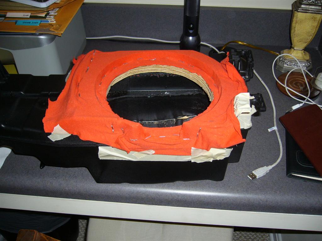

I glassed in the rings yesterday afternoon. I am having problems getting the resin to set up. I left it over night and this morning it is still a little tacky. I am pretty frustrated. This is not my first time working with fiberglass. The first batch I mixed as per the instructions was way way too hot. The plastic cup ended up melting and smoking. The second batch was still too hot. No smoking but it kicked in just 2 minutes. The last batch I mixed has still not set up. I guess I put too little hardener in it...
I am going to mix up a hot batch in a few hours if it does not get set up anymore.
I got the sub in the box this morning. I found a few holes I missed with the resin. (the hot batch worked!) Once the glue sets up I'll give it a try again. The amp is making the sub move pretty well...

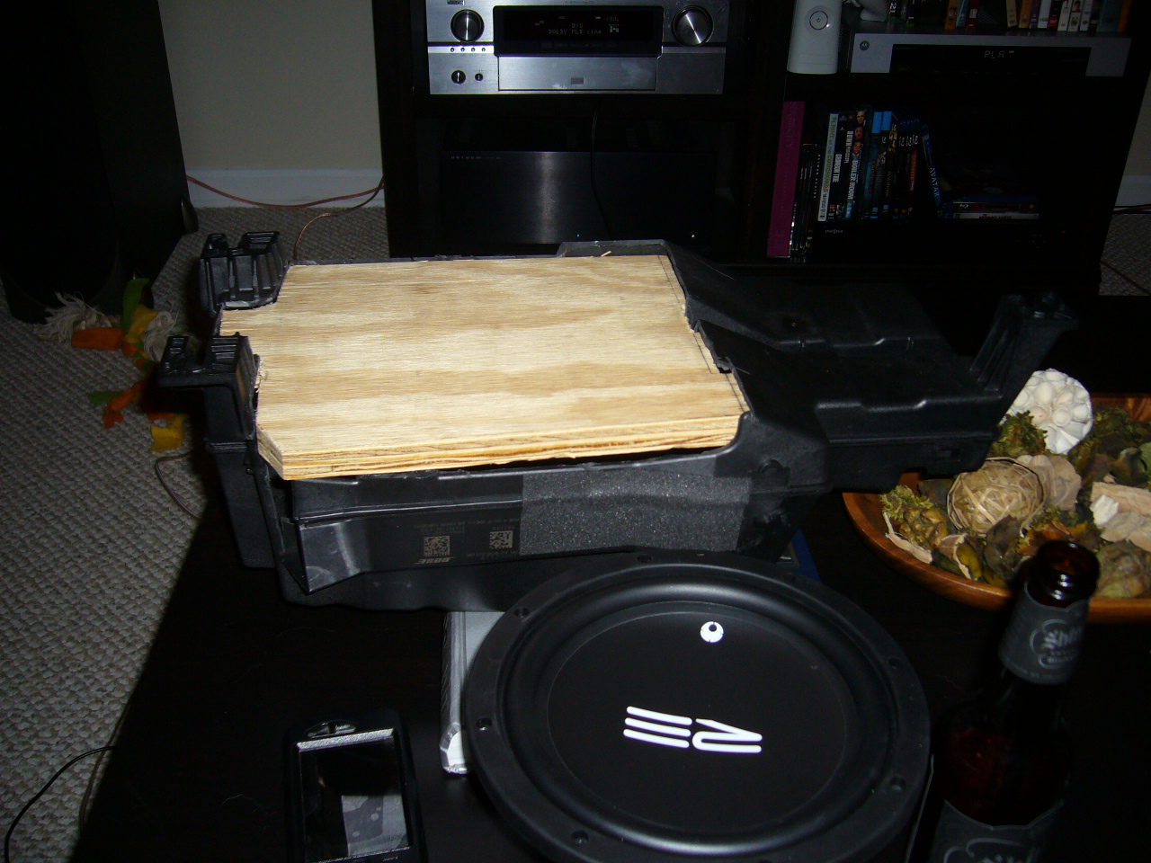

Did you cut out the bose box to add your own sub? How much volume is the bose box?
box internal volume: 7.405L(.261cuft)
port volume is .013cuft
add em up if you plan on not using the port

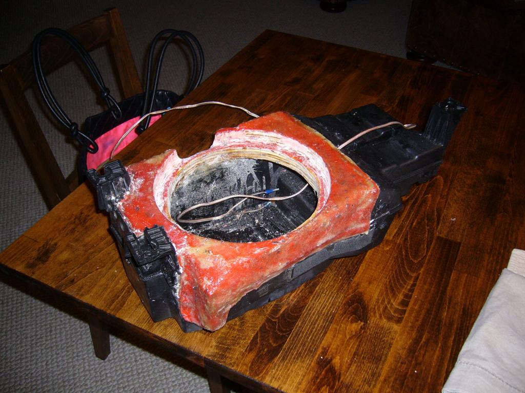

When it finally stops raining I'll take the other one out and put the new one in. The box still has a pin hole leak in it. Fiberglass was not the way to go.

I'm going to button everything back up after I find all of the pinhole leaks. After a few days I'll report back. Crossing my fingers. :fume:
Here is some more box building pictures.
