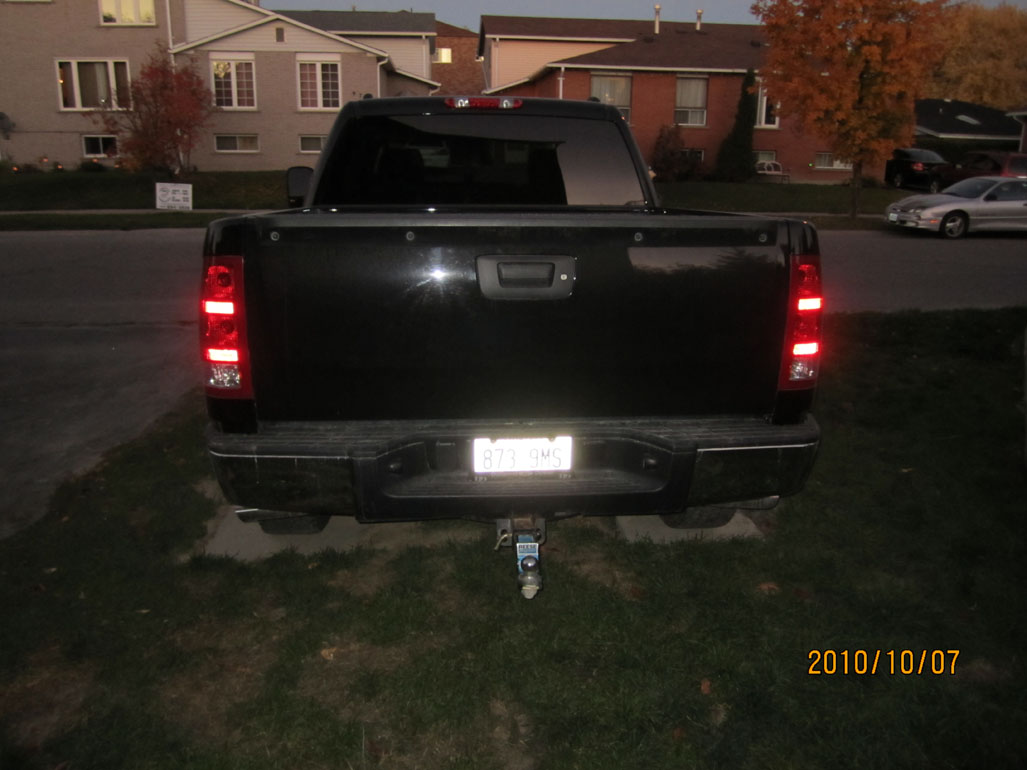

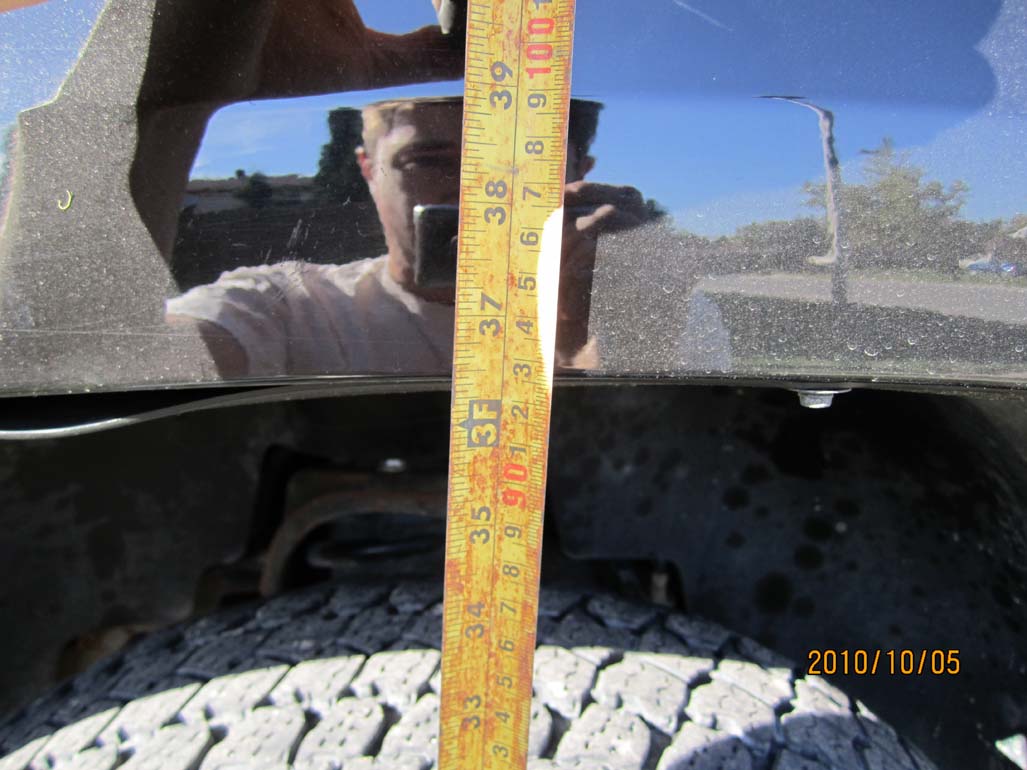

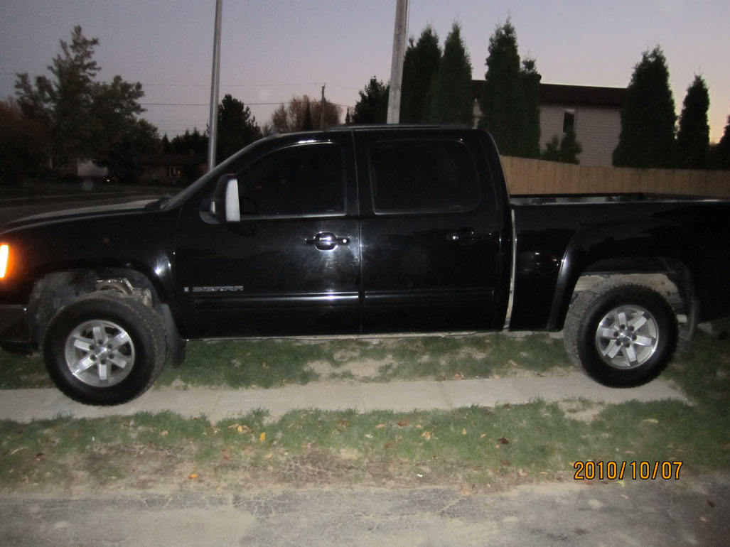

Installed my 2" Skyjacker leveling kit the other day. Looks so much better then stock! Oh ye also debadged the tailgate
Before
After
Tailgate

Either 285/70/17 BFG A/T's or Goodyear Duratracs to come in the spring. Will definitely finish the look.
Forgot to mention though after getting this done went to get an alignment and found out that I need both lower ball joints changed and one upper. Bought the extended warranty so that's going in on Tuesday. If it was out of warranty Moog parts would be going on but might as well get OEM for now.
