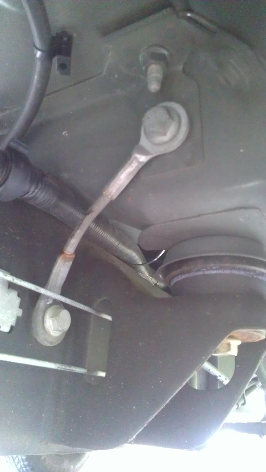

did you have to deal with this strap on the drivers side? anyone know what needs to be done?
^ sorry no one is responding to your question. I would take it off, it doesnt look to be electrical and if anyone chimes in and if its necessary put it back.
I think i seen that listed as a body teather on here some were and really has no purpose. If it were me i would call/email the maker of your kits tec line
