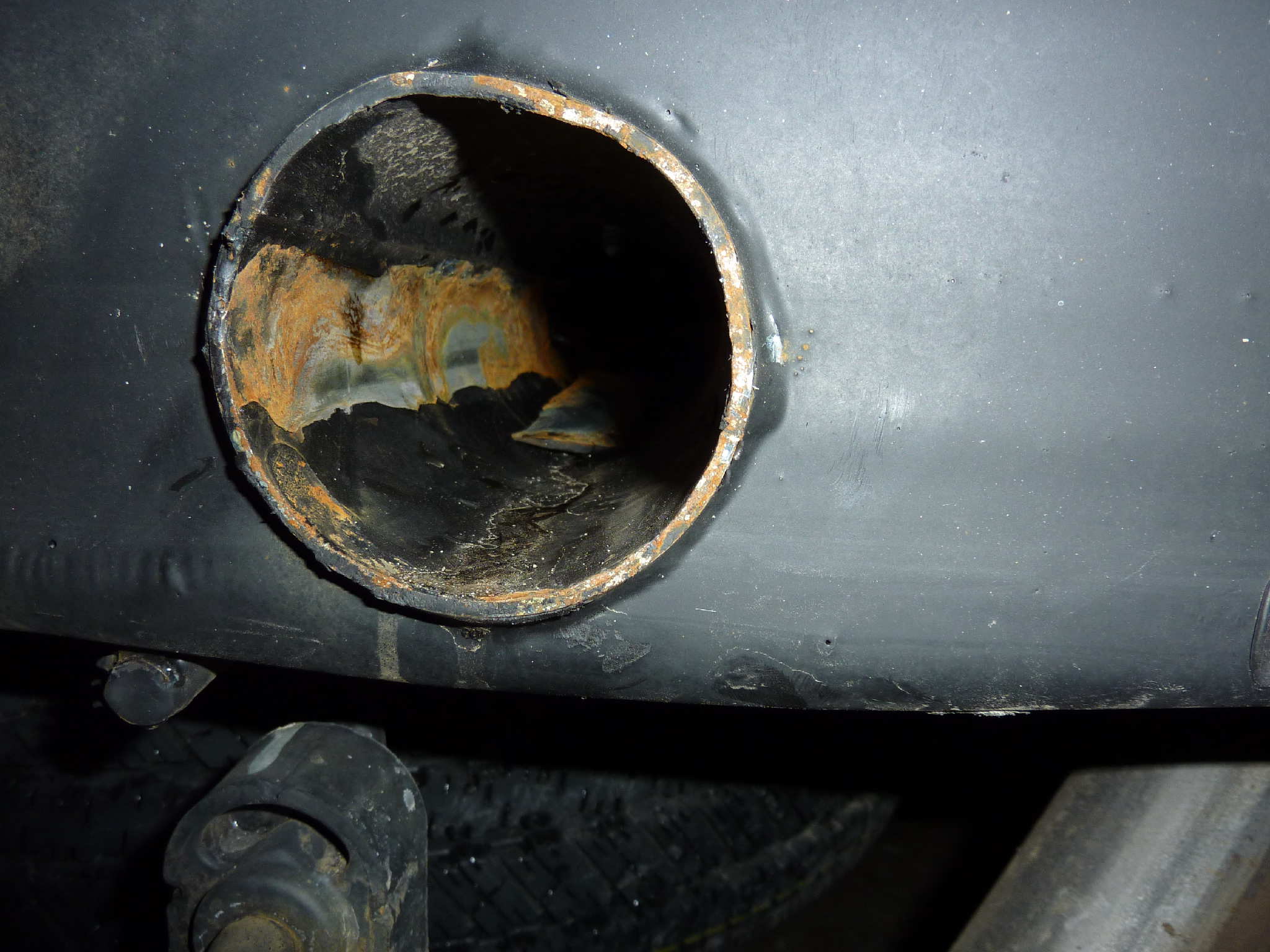

On my previous trucks I had always hated the open tubes that are visible in the rear wheel wells. I ran across these plugs on ebay. a few days ago. So I went ahead and ordered. They fit like a glove. They should keep a lot of gunk out and do makes things look better in my opinion.
