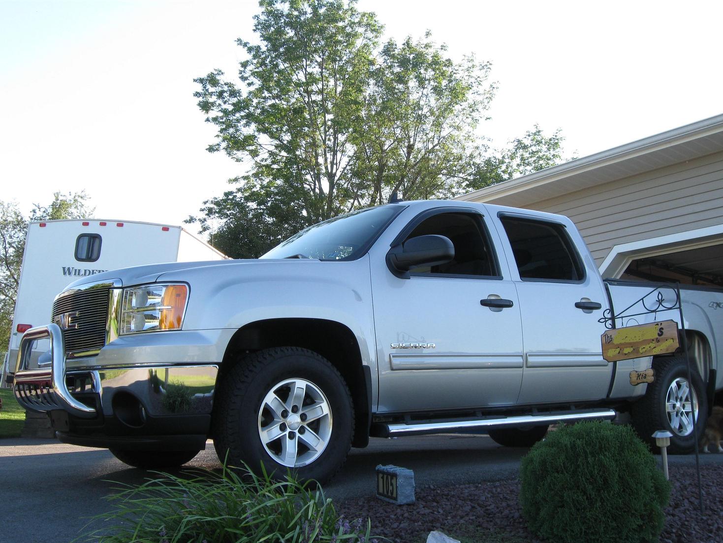

Now for some pics, sorry their not that great, and the truck is filthy:
Mirrors:
Inside view:
Inside view signal on:
Done:
and a pic of the new Centerline Grizzlies and Cooper zeon ltz's (275/70/18) before we mounted them up:
O and just and FYI the signals worked fine, and with no programming coming from just power heated mirrors, I believe the programming only comes into play with the power folding mirrors.
