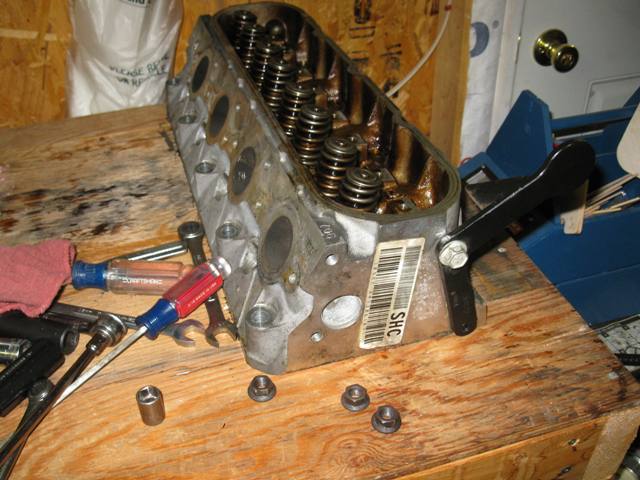

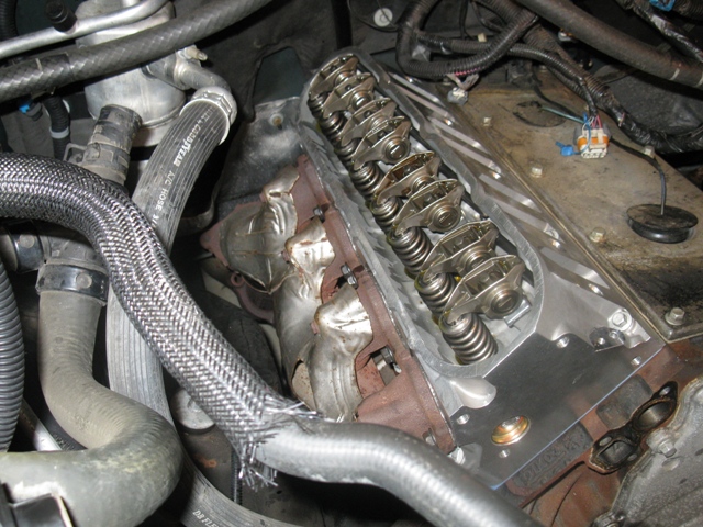

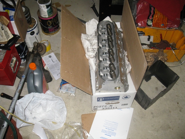

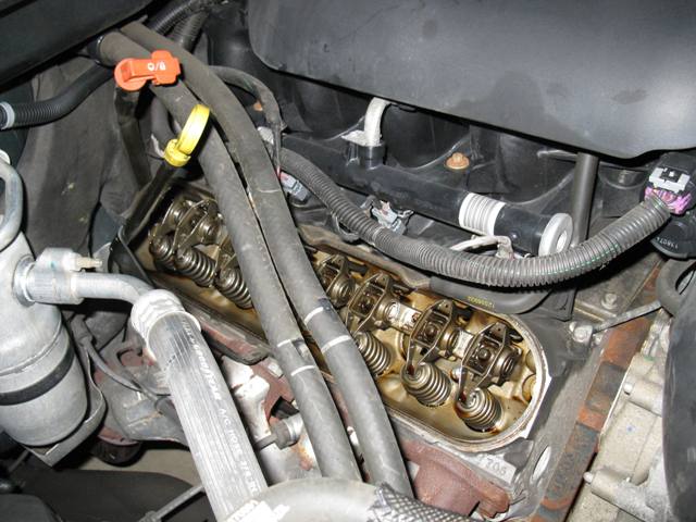

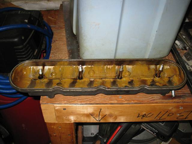

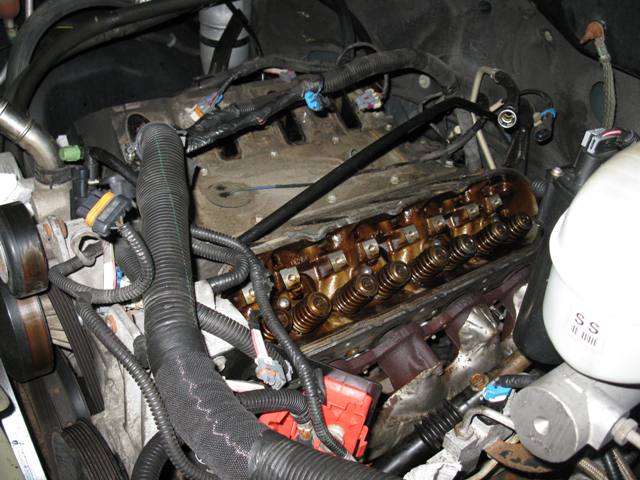

I finally got some warm weather and started to put my truck back together. Pics are from tear down to installation of passenger side head.
Dexcool/Oil Mixture:
Driver's Side Head pre removal:
Passenger side did not look too bad:
Better look at driver's side:
On the bench:
Replacement Heads in the box:

Push rods, rockers, and exhaust manifold reinstalled:

What symptoms led you down this path? Was it mysterious coolant consumption? Was there any excessive enging noise? Did your exhaust studs come out okay?

I had coolant loss with no leaks and it developed a stuck lifter. Exhaust studs came out surprisingly easy.

Great pics!!! Thanks for posting! I would love to know where you got your heads from and what else you bought to do the job right.

I got my heads from Ritchie Automotive Machine in Capital Heights, Maryland. The owner is a very old friend of my father's.
The heads came from a company in Canada.
This is what I've bought so far:
New lifters
All new gaskets
New head bolts
New exhaust manifold bolts
New spark plugs
New spark plug wires
New radiator hoses
New water Pump
New idler pullies
New serpentine belt
New A/C belt
GM shop manual for the Silverado
Torque wrench
Torque angle gauge
