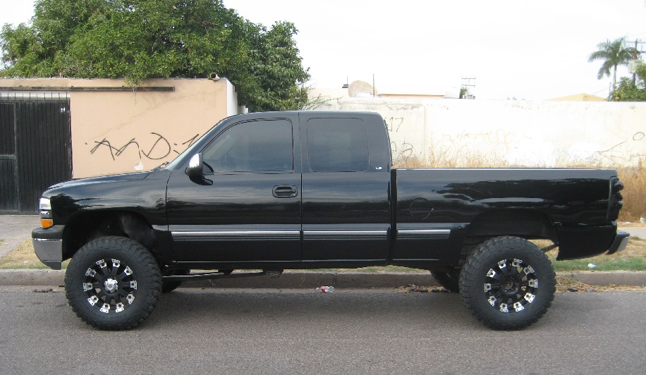

i personally don't like body lifts... i would remove the body lift! and get the 6" lift! i have a 99 silverado with a 6" lift and 35x12.5 tires... here's how it looks so you can get an idea! i don't have any problem at all with the tires rubbing when doing sharp turns or what ever....

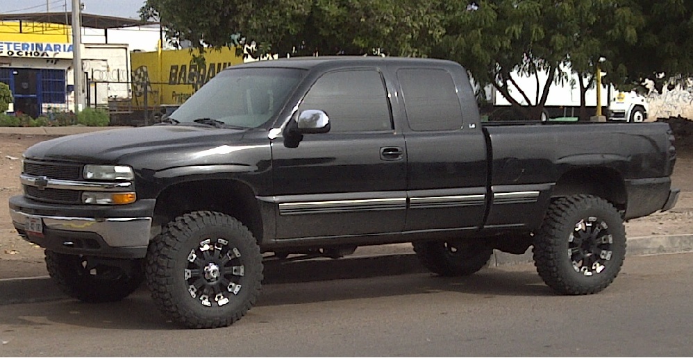

6" skyjacker
315/75tr16 BFG K/O's
16 x 8.5" with 4.5" backspacing

Stevens11, is that truck with a 6 inch lift?
Yes... 6" Skyjacker and loved driving it everyday.
