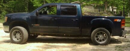

Im running 305/55/20 Nitto Terra Graps on my 07 Sierra with a 3"BL and 2.5 spacers and I still rub a bit. I trimmed the plastic and I think I'ma cut a little corner of the metal too cause it gets annoying as hell. My wheels have a -12mm offset(I think) maybe -10mm, dont really remember. I'll post some pics tomorrow and show you. I was warned on here about rubbing, but I did it anyways. F$%K IT! Just back and forward a few times or eat the curb when you can and its all good. About the mudflaps idk though.
