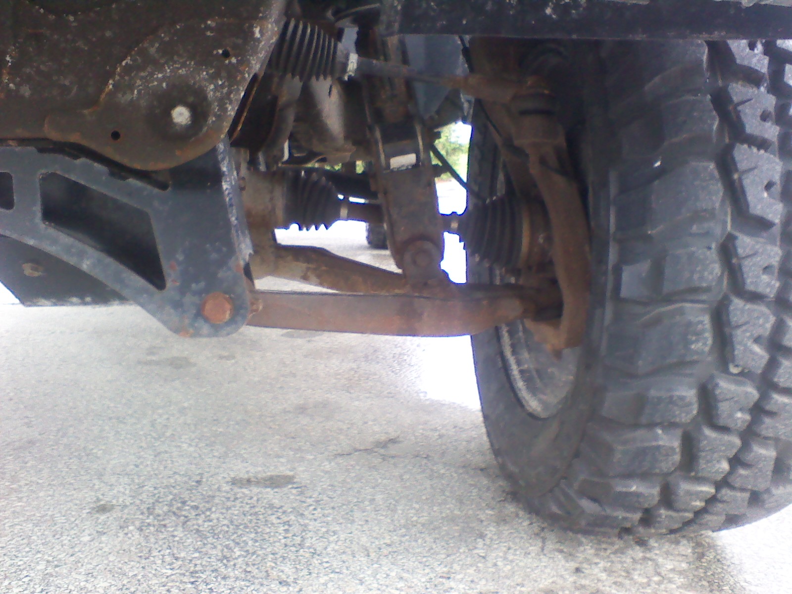

I am workin on it.. Weather has been terrible here for basically the entire month of april. The underside of the truck is filthy.. This weekend I am planning on getting under there and cleaning everything up, then if i have time give it a wash and wax job too. I have a pic of the CV angles though i took from my cell phone ill post it.
OK i forgot i took a quick pic in the walmart parking lot because i parked beside a stock truck just for a comparison. If you look at the mirrors you can really tell how much higher it is.
The 2nd pic i tried to get a picture of the CV angles of the Fabtech + 1.5" spacer. What do you think about that?
Also you can see how nasty the underside of the truck looks right now.. It looks like rust, but its really not, its from driving the truck in a few steel mills recently. Its all stained I am gonna get under there with degreaser and a pressure washer and what i can do. Probably going to need to do some painting to touch it up.
Your angles look perfectly fine to me. I can't see how your UCA's would be contacting the droop stop.
The UCA clearance isnt as bad as I thought, I still probably have half of the droop travel as stock with this setup. I also have no problems using 4wd at higher speeds, (i was concerned since there is so much suspension lift.)
The truck looks so much better now, the extra 1.5" up front is perfect when mated up to the 2" rear shackle. It just sits level, no more cali lean, and it also brings the truck up to match the other guys like ram 1500s and f150s with 6" kits. Even the silverado with the 8" lift and 305/55/20s was a tad lower than all the other makes, just because of how low the thing was to start with. Now with 9.5" of lift and 35's its atleast as big as a ram or f150 with the 6".. If that makes any sense.
