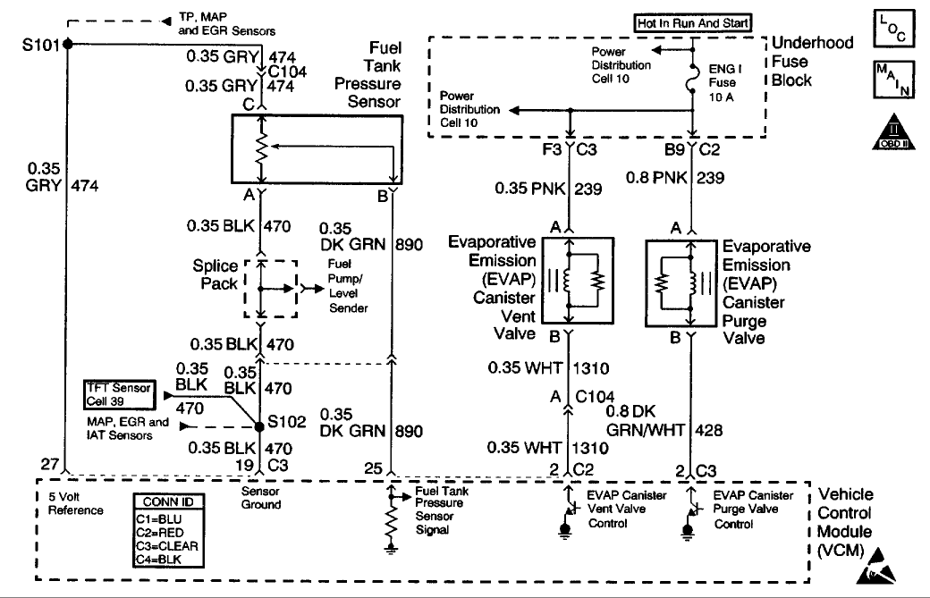

These all point to my EVAP system. I had my Fuel tank pressure sensore replaced yesterday and still have the same codes. SO I naturally assume it's an electrical issue along the chain. I've included an easy diagrram of my EVAP electrical system to help in troubleshooting.
2001 Bravada EVAP Electrical Diagram
I read somewhere that a bad 5 volt reference can ruin the whole EVAP process causing bad readings. I'm basically wondering if these are all specific problems or can I solve them by fixing the ground at the PCM.
P.S> I've recently had my canister hose checked for leaks and it's all good. I got a new fuel pump recently as well.
Without a 5V reference, the first indicator would be a non-operating fuel pump & gauge. That's the easy part.
P0446 GM
EVAP vent system performance
– The FTP is less than -2.0mm Hg(-1in H2O) .The ECM detects a large leak in the EVAP system.For more than 4 seconds
Probable Cause
1. A damaged EVAP vent valve ,A damaged EVAP canister
2. Pinched or restricted EVAP vent hose
3. FTP sensor
P0449 GM
EVAP vent solenoid control circuit
– The ECM detects the voltage on the EVAP canister vent valve control circuit is between 2.6-4.6 volts when the driver is commanded off,for more than 4 seconds
Probable Cause
1. Open or short circuit condition
2. Poor electrical connection
3. EVAP canister vent valve
4. ECM fault
P1639 GM
PCM 5 volt reference voltage circuit condition
– The ECM has detected a fault in the 5 volt reference voltage line
Probable Cause
1. Sensor using 5 volt reference line shorted to ground
2. Circuit short to ground
