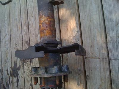

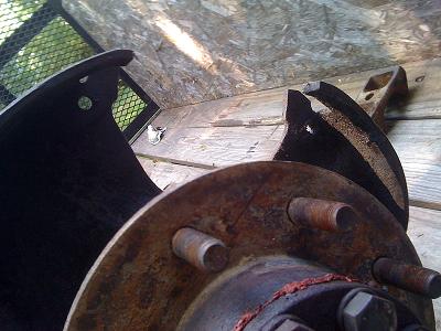

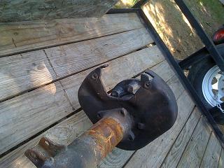

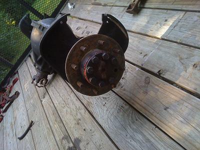

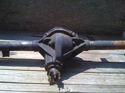

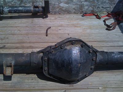

I purchased a 14b with what looks like factory disc brakes but it came without the rotors and calipers. I wantt o try and identify it so I can buy rotors calipers, brakes, etc... CAn any body help me with the year and make this may have come out of? The axle details are as follows:
Numbers on carrier housing:
CFD
135
3977323
From this it looks like the older style (pre-87) with drums but the pics below look like a factory disc style:
I figured it out. It has a 1/2 ton backing plate on it from the front d44 or 10 bolt. This is used for a common 3/4 ton caliper and rotor disc brake conversion. I just need to get the calipers and rotors.
