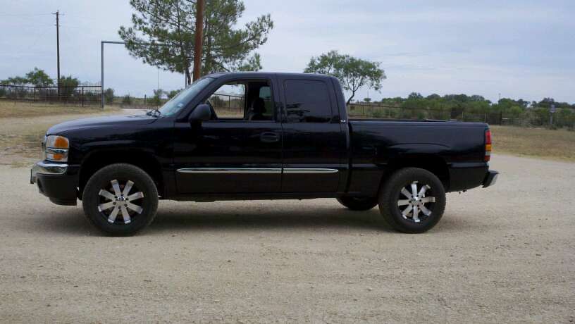

Pic's are before and after torsion bar crank.
With the new rims and tires 285/60/18 toyo a/t I lost 30-40 miles to the full tank of gas, and thats keeping my foot out of it.

Also this pic is current and months after I did the torsion bar crank, it seems to have added the rake in front again, is this bad shocks? I know the front is the heavier end of the truck, the bump stops were clearing after crank, but they are slightly touching now.
The shocks are originals with over 115 thousand miles, which I know is well over due, but if I do replace the shocks will it pick up the front again or will I have to crank again after new shocks to get level?

Well, your torsion bars are "tired" somewhat. Your shocks have little to do with front end sag. Also,. you say you lost mileage with the 285's, but did you re-program for the 285s? If not, then your mileage isn't reporting correctly. If you did.... obviously the 265's would help gain that mileage back due to the weight difference. And I don't believe the 265's will look small. They'll be fine. :)
