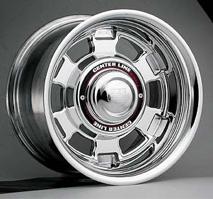

2. Half-inch wider wheels out back. (Not an option with my aftermarket wheel choice--20"x8.5" with 6" backspace Centerline Vectors: Centerline Wheels.)

Also, opinions on that wheel choice? Centerline? Forged aluminum? Chrome versus Hi-polish?
Personally, I like this wheel because it looks like a truck wheel--not a hot rod wheel or anything too fancy--no offense to anyone else's taste. And the price sure beats GMC's accessory wheels--or even "replacement," plastic-faced RO8's, etc. This is a better image, IMO (different center cap):
