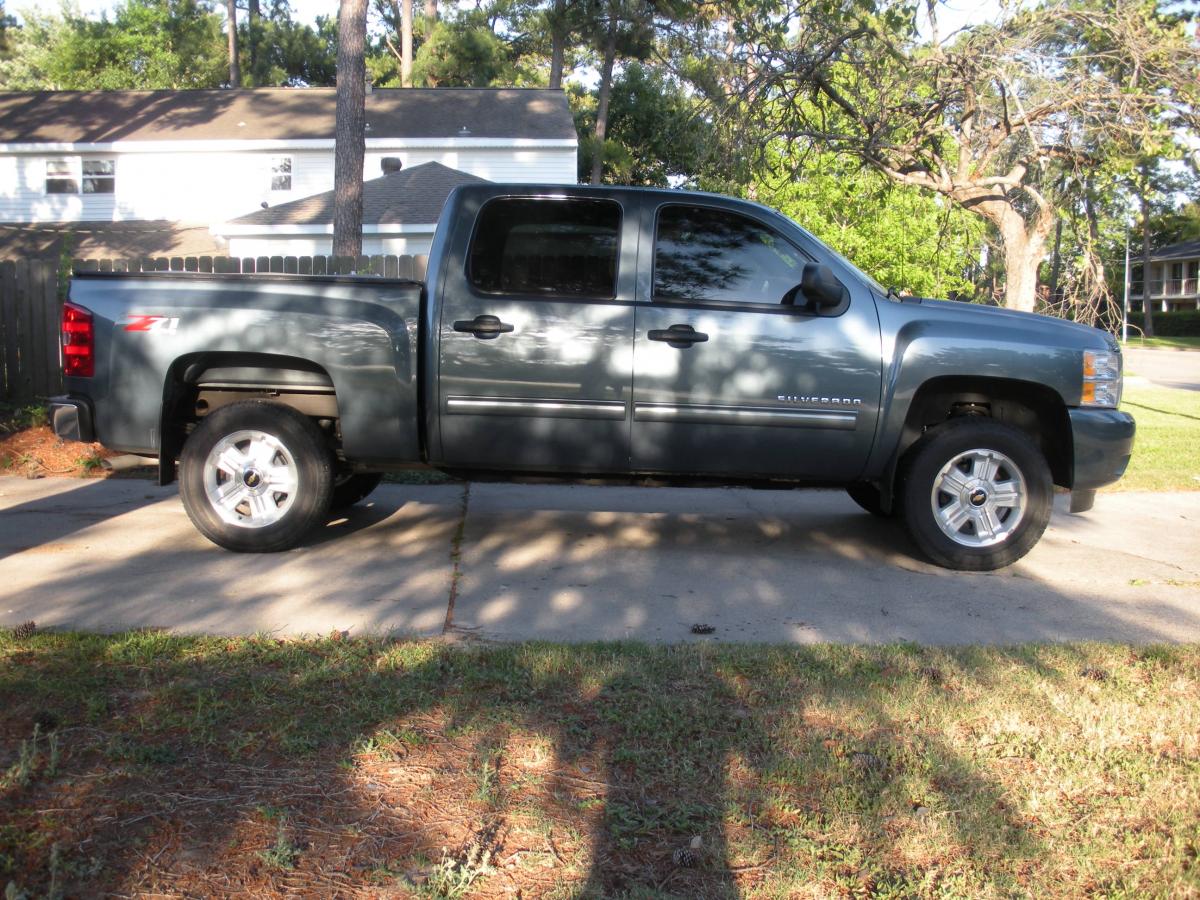

3" Blocks
Got 'em on today. I messed up and the pin didn't align on the passenger side, as happened to OP in this thread: http://www.gm-trucks.com/forums/topic/140152-leveling-kit-block-install-problem/?hl=%2Blift+%2Bblock+%2Bservice+%2Bstabilitrak . Fortunately for me, that thread exists and I was able to figure it out. Here's the measurements:
Before:
FR 38.75
FL 38.5
RR 38.5
RL 38.75
After:
FR 38.75
FL 38.5
RR 40.5
RL 40.5
Before:
After:
looks good. i would get some rear wheel well covers make it all blend it better so you doint see as much frame
I've been planning on getting them. They're next on my list of upgrades.
