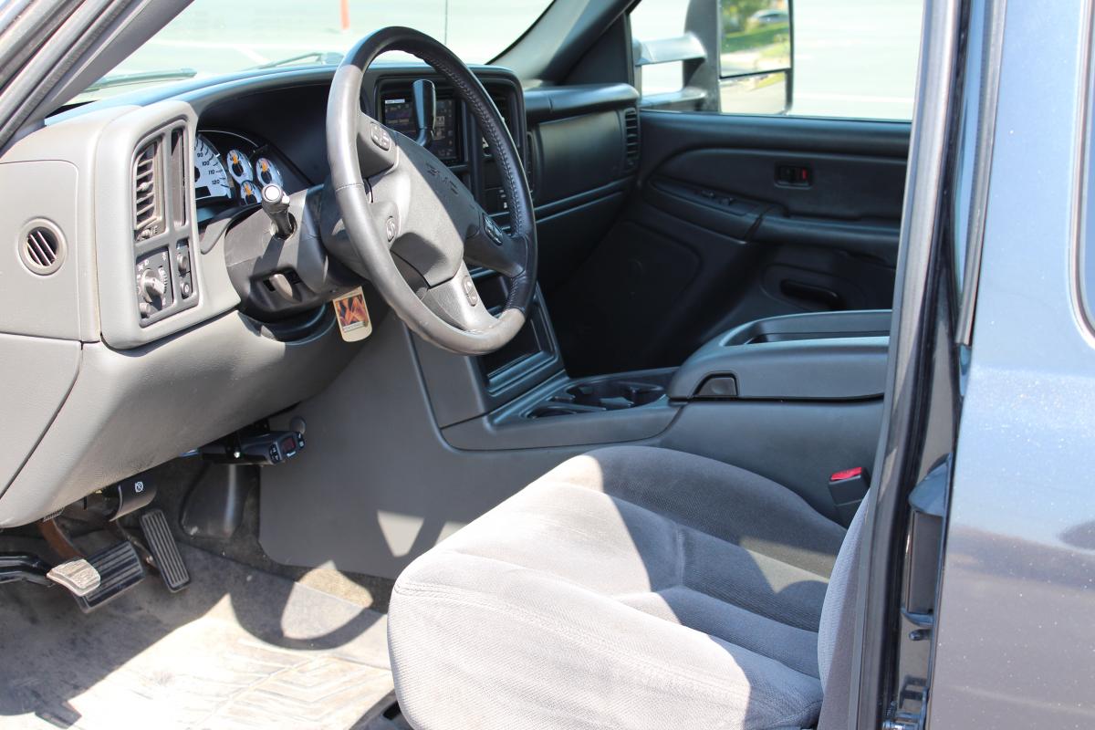

Ok I have 92D/92I very dark pewter interior. From the factory the headliners and visors are the shale color. Here is my interior.
If you look at this truck that has 92D interior the headliner is shale

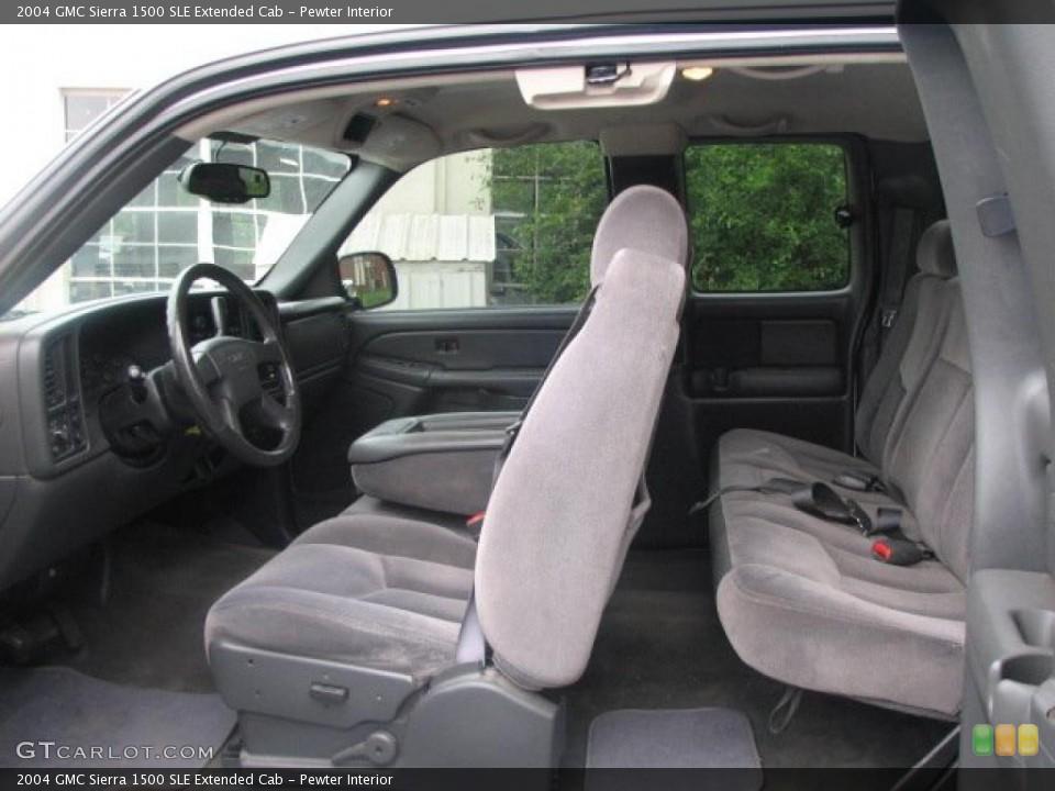

Those PN#'s are off my father's 2004 VHO which had the light pewter leather interior. My 2004 GMC VHO had the dark graphite leather interior & the headliner & sunvisors were also this same shale color. Hope this helps......
I greatly appricate your help.
My headliner, sunvisors, dash and seats, are the same color, pewter / light grey.
