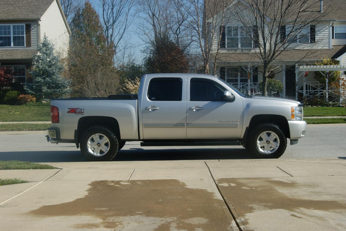

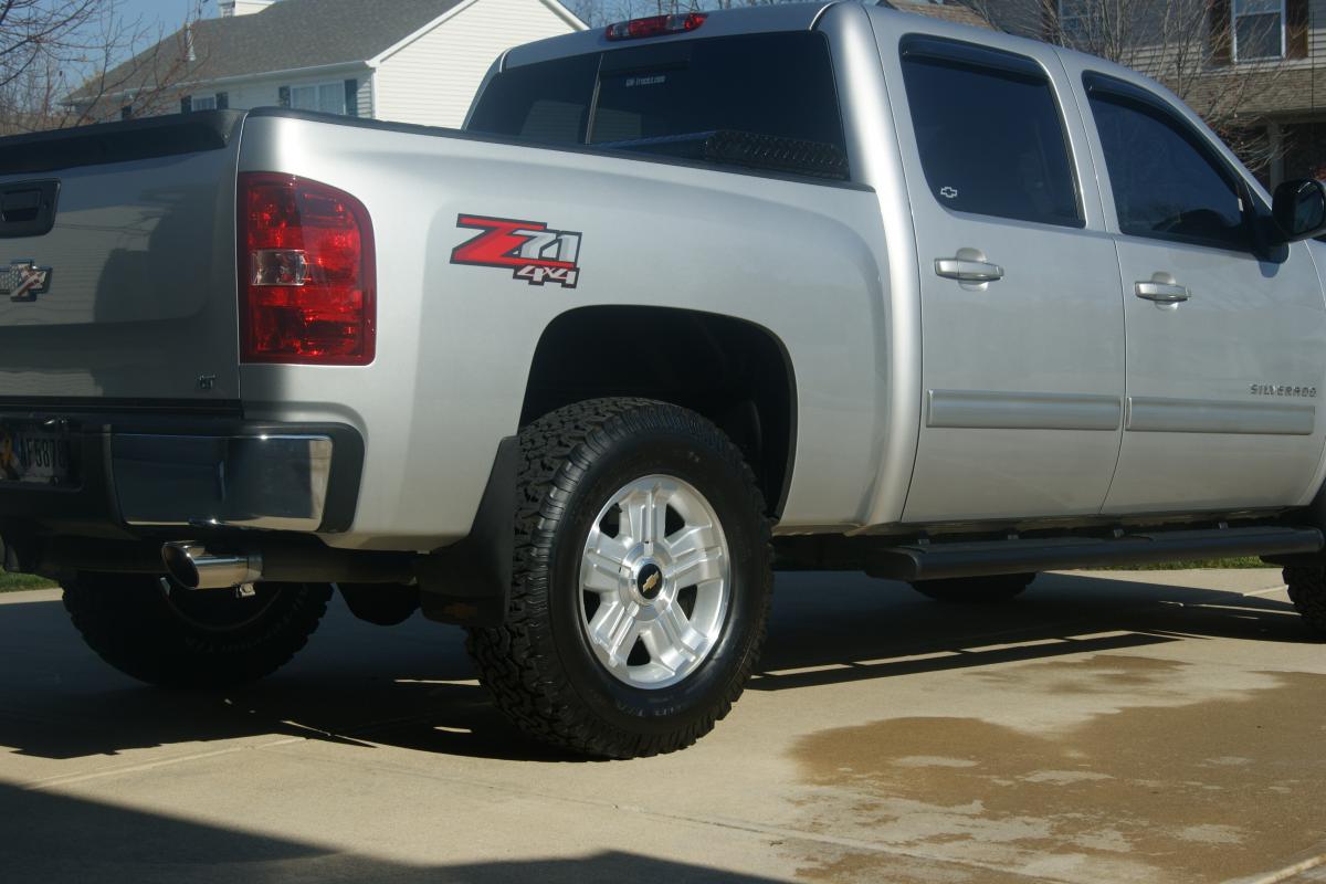

20130202_145137_zps7208f242.jpg20130701_193825_zpsb020ceb0.jpgI also did the 3 blocks in the rear, but my front level kit is the 2.5" . I don't like a saggy a** when Im towing my boat.
Thanks guys for the replies and Great pics. I think I like the 3", to bad they didn't make a 2.5" That might be just right, Lol
