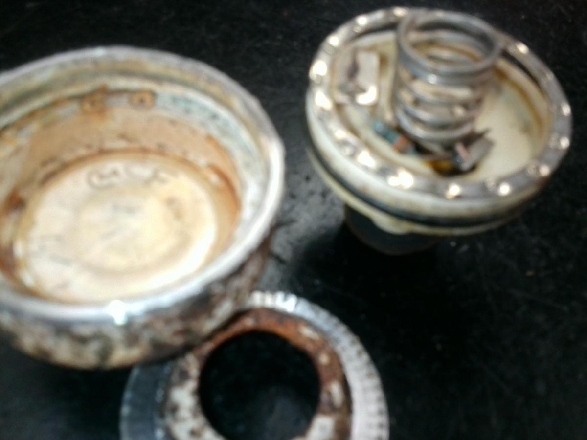

PO 332 bank 2 sensor(rear) wasnt really that bad t change, but then again i work on glass vial making machines for a living , was way easier than i thought
heres a pic of the bad knock sensor opened up on a lathe. sorry its not a better qaulity pic
That's deadly. I have the 332 code as well so will be doing them both with new harness; I'm anticipating things to run a little smoother...
