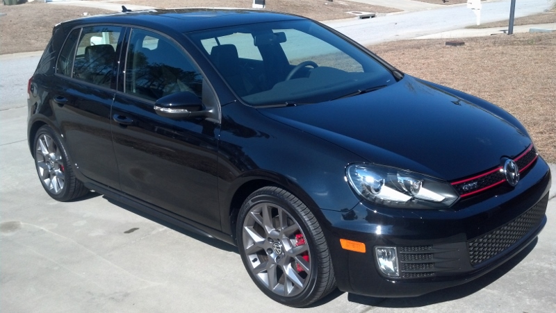

So, I know this is an truck related forum but I don't plan on leaving anytime soon and like the community better than other forums, that being said, I have decided to do a build thread for my GTI I recently purchased. For some specs, its a 2013 Driver's Edition which come's standard with the 2.0T with DSG tranny. 200hp and 207ft/lbs of tq. This thing will move! Also has leather heated seats, nav touchscreen, sunroof, 18in rims, first aid kit lol, Adjustable HID's, they turn with the steering wheel and also sense uphill/downhill and move accordingly, and probably a bunch of other stuff I have yet to discover. So far it has been an excellent vehicle and I think it will last us for as long as we keep it. Knock on wood just in-case but, here are some pics I have already posted once before. I have received its first performance mod today so tomorrow I will be installing it!

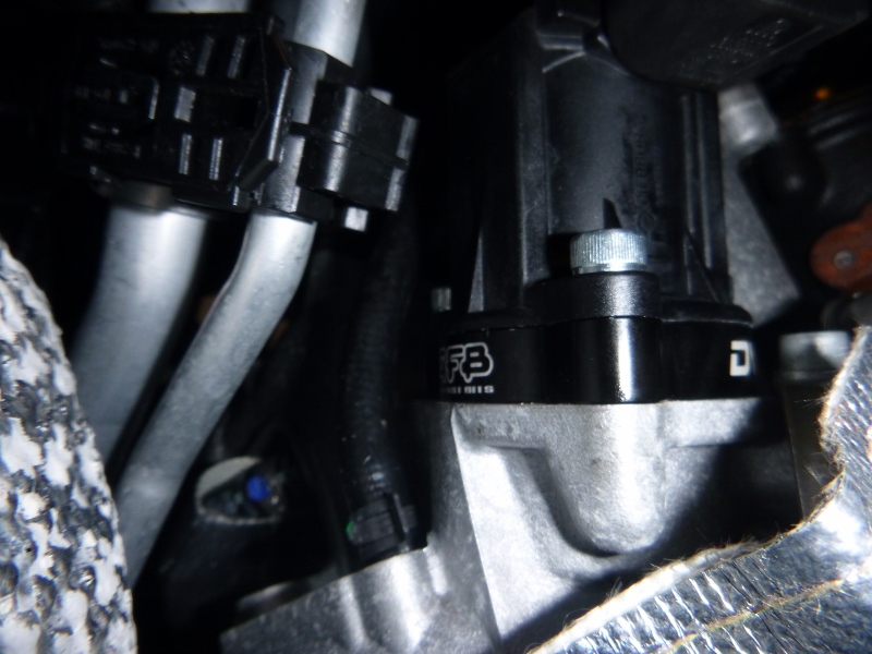

Here is the install.
Helps to take the wheel off at least. There is a vid of some guy doing it without it but my arm's would not fit with the wheel on.

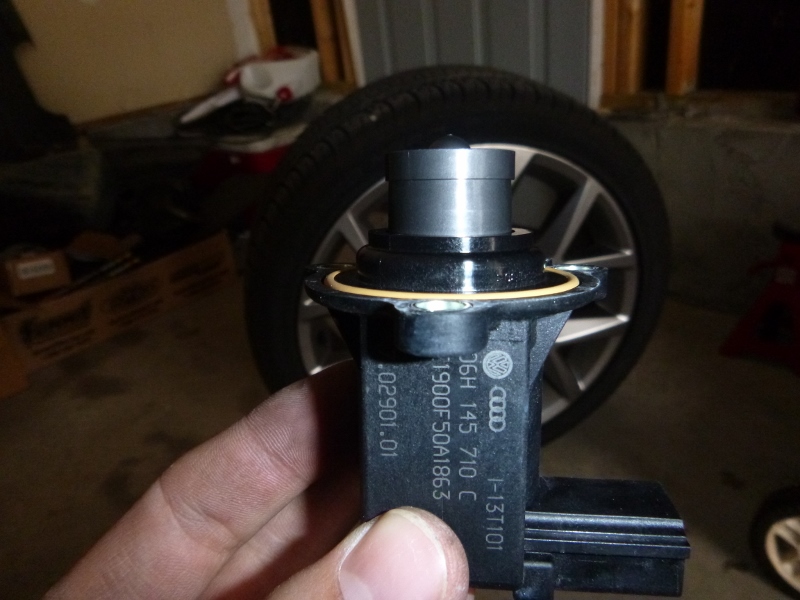

This is the stock diverter valve before removal.

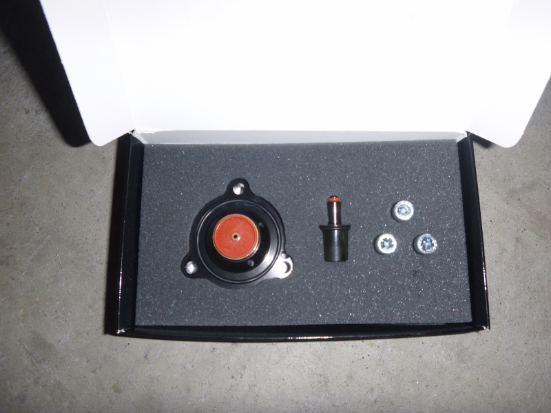

Here is the product.
Once more but of the parts. Pretty high quality when I was comparing the OE equipment to this. All metal components compared to metal and plastic.
So basically, this new DV+ valve has all metal components that allow for better performance and no leaks. It also keeps the boost flat and doesn't taper off as quickly and bounce around the place when your accelerating/decelerating a lot. This was definitely noticeable when driving around after.
Here is stock DV removed
Stock internals

Final Install
So far so good. Not sure if a tune will change the performance of this but from what others are saying, it actually helps rather than deter. Now this DV is also not pneumatic. Its electronically controlled by a solenoid from throttle position. Supposedly, this is the fastest type of DV you can get compared to pneumatic so turbo response is also faster.
