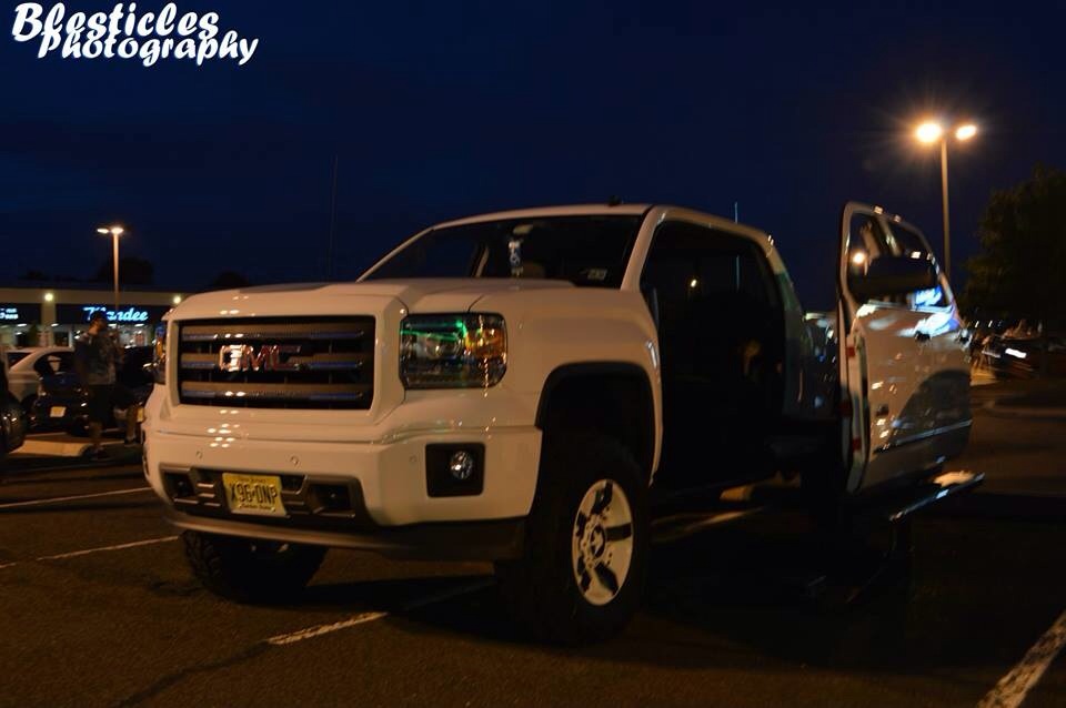

Okay so my truck had a 3 inch body lift and they added a 1 inch rough country level and I was able to fit 35 inch tires. I do have a very slight rub at full but it's definitely nothing major and I only trim a tiny bit of metal. I have 18 inch rockstar twos Huston painted with a zero offset. On 35 inch kuhmo road venture m/t tires
