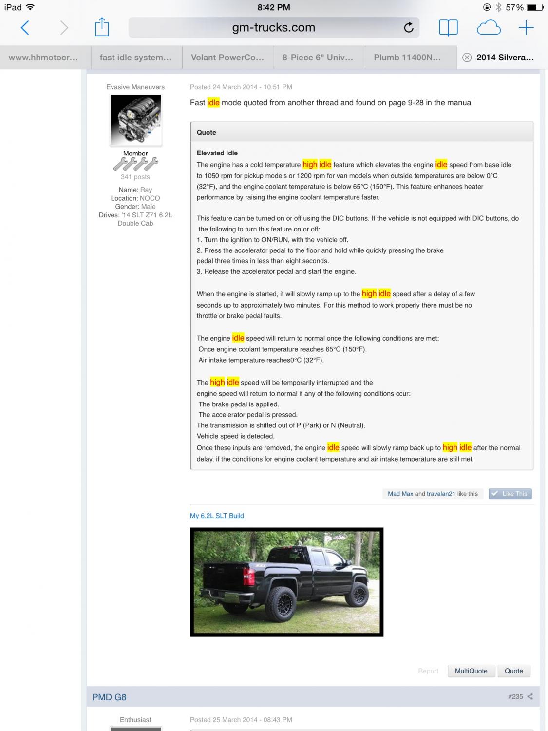

Here's a screen shot of the post I saw about a year or so ago.
Elevated idle is a diesel only feature. (your pic is from the Duramax supplement)
Dmax trucks can have both the Elevated idle AND the Fast idle.

cut and paste:
Elevated Idle
The engine has a cold temperature
high idle feature which elevates the
engine idle speed from base idle to
1050 rpm for pickup models or
1200 rpm for van models when
outside temperatures are below
0°C (32°F), and the engine coolant
temperature is below 65°C (150°F).
This feature enhances heater
performance by raising the engine
coolant temperature faster.
This feature can be turned on or off
using the DIC buttons. If the vehicle
is not equipped with DIC buttons, do
the following to turn this feature on
or off:
1. Turn the ignition to ON/RUN,
with the vehicle off.
2. Press the accelerator pedal to
the floor and hold while quickly
pressing the brake pedal three
times in less than eight seconds.
3. Release the accelerator pedal
and start the engine.
When the engine is started, it will
slowly ramp up to the high idle
speed after a delay of a few
seconds up to approximately
two minutes. For this method to
work properly there must be no
throttle or brake pedal faults.
The engine idle speed will return to
normal once the following conditions
are met:
. Engine coolant temperature
reaches 65°C (150°F).
. Air intake temperature reaches
0°C (32°F).
The high idle speed will be
temporarily interrupted and the
engine speed will return to normal if
any of the following conditions
occur:
. The brake pedal is applied.
. The accelerator pedal is
pressed.
. The transmission is shifted out
of P (Park) or N (Neutral).
. Vehicle speed is detected.
Once these inputs are removed, the
engine idle speed will slowly ramp
back up to high idle after the normal
delay, if the conditions for engine
coolant temperature and air intake
temperature are still met.
Fast Idle Control
The vehicle may have this system
which can be used to increase the
engine idle speed.
Fast Idle control will be enabled
when the following conditions
are met:
. The parking brake is set.
. The transmission is in P (Park)
or N (Neutral).
. The vehicle speed is about
0 km/h (0 mph).
. The cruise control is in the On
position. See “Cruise Control” in
the owner manual.
. The cruise control Set switch is
pressed and released for Preset
Fast Idle Speed (1200 rpm).
Fast Idle control will be disabled
when one or more of the following
conditions occur:
. The cruise control is in the Off
position.
pressed and released. See
“Cruise Control” in the owner
manual.
. The cruise control Cancel switch
is pressed.
. The brake pedal is pressed.
. The parking brake is released.
. The vehicle speed is not
0 km/h (0 mph).
When Fast Idle is active, a
FAST IDLE ON message will be
displayed in the Driver Information
Center (DIC). See Starting the
Vehicle Messages on page 5-12
