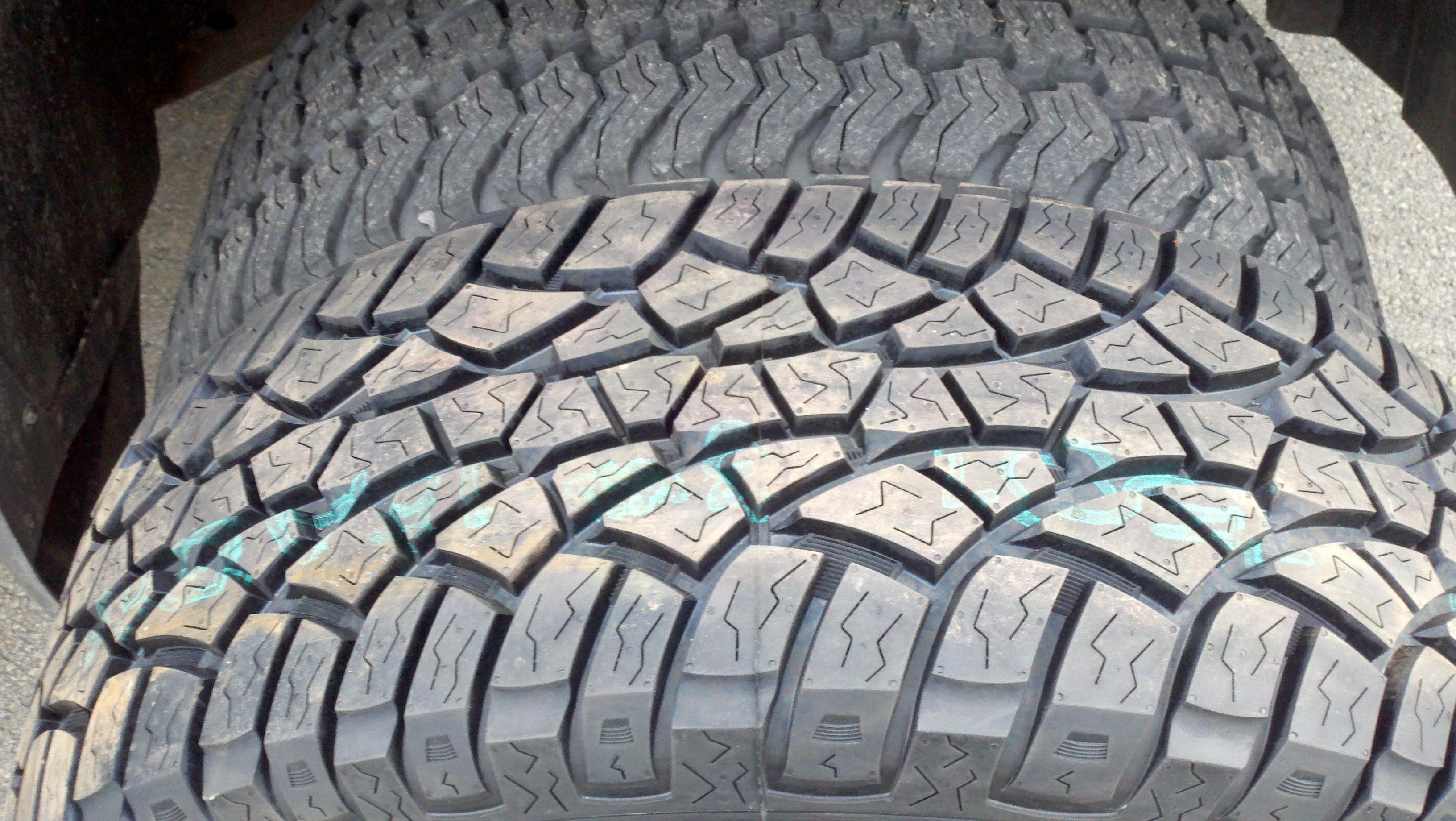

I have a 2008 1500 with 2" RC level and the RC 1.25" body lift. I run 275/60/20 Cooper Zeon LTZ tire on a +25 offset MB Gunner 6 (20x8.5) wheel with no rubbing...in the summer months. I just put on 275/60/20 Cooper AT3's on my factory stock 20's (20x8.5) in the fall (+31 offset) and it rubs backing up at full lock, but I am not 100% sure if it rubs the stock mud flaps or the inner plastic of the front wheel well. That being said the AT3's are a lot "taller" than the Zeon's when I stand them up side by side off the truck.
some pics with Zeons ...
