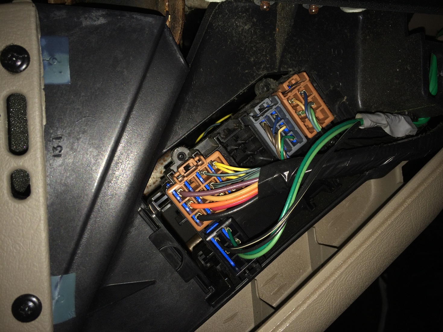

This is my current left and right hand side fuse block where the harness p/n 10398012 for the left hand side and p/n 10398010 for right, respectively goes in. The question is: Would these two fuse boxse work after a BCM replacement which came from a 1LT silverado with these two wire harnesses plugged in along with the window regs from Dorman and a OEM GM door lock actuators, power mirrors and courtesy lamps and of course, a 03-06 Tahoe Neutral and Tan door panel from an LS edition.post-112461-0-79660600-1429500763_thumb.jpgpost-112461-0-66507400-1429500770_thumb.jpg
more pics..Anymore I need to take?
