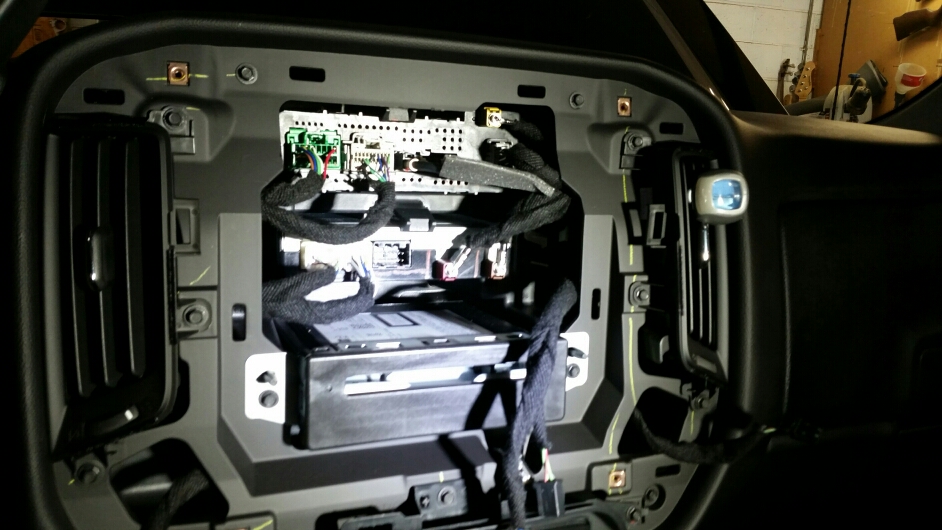

When you get the screen off and out of the way this is what you will find. To make room for the new head unit you will need to cut quite a bit of plastic. I hAve replaced the factory screens with after markets in every factory configuration so far. The cd mech, onstar module, tuner, and amp if equipped are all separate pieces. All of them are behind the screen with the exception of the bose amp which would be on the back wall behind the seat.
Many people have been disappointed with the factory sound quality with and without bose so I have replaced many. Typically with a Kenwood unit with the Garmin nav. They're Nav is the best in my opinion.
