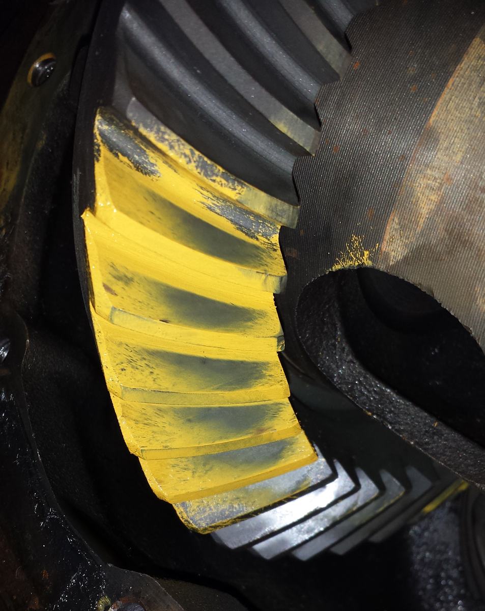

Rebuilding the 10 bolt differential on my 02 silverado 1500. Wondering about my ring gear contact pattern and what you guys think about it (see pic below). Do I need to adjust the pinion depth of carrier shims with this contact pattern? Backlash measured right on at .008".
Is that the spec in the book? I have done gears on a smaller scale, not automotive differentials though
That would fall in the acceptable range. What about the other side of the teeth. You need to see both to determine if adjustments are needed.
