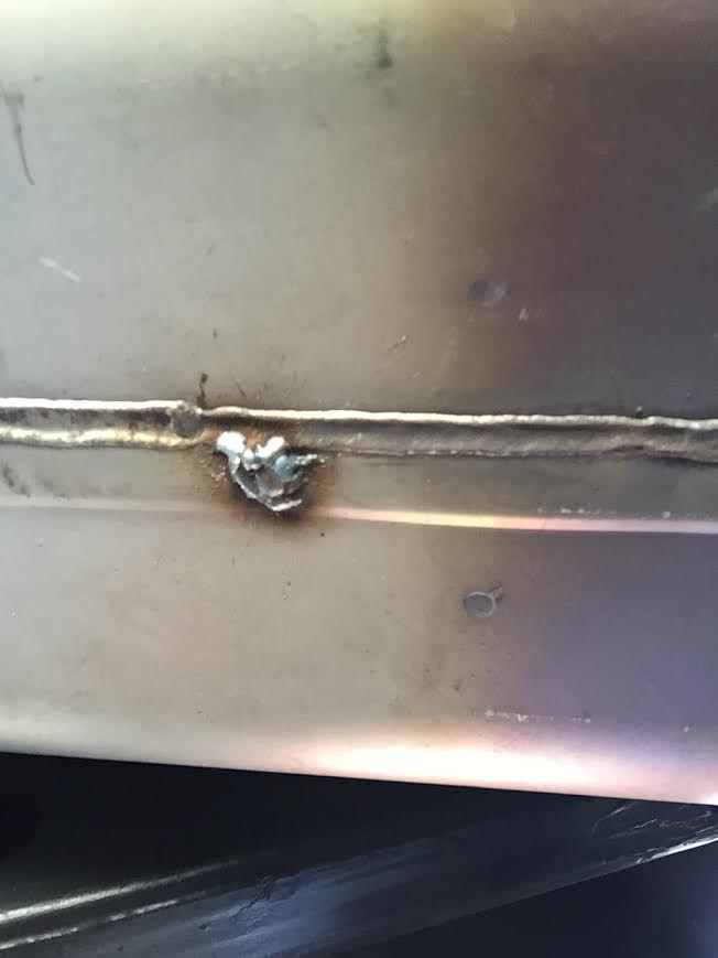

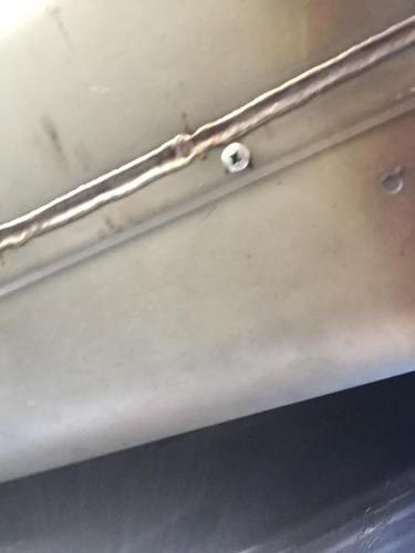

Its 7 inches back from back end of the body of the muffler on the seam. I used a 1.5" stainless self tapping screw (but it was easier to drill the hole first). I drilled through the bottom and then as straight as possible drilled through the inner pipe. Then i used a small allen wrench to make sure i was in the correct spot (push up through and feel the valve moving) Then run the screw into place and weld it up.
NOTE: this image is upside down. I did this from the bottom side of the muffler while it was on the truck

the top picture has the axle on your right hand side?
top picture was taken via the face time camera facing the sky. Not sure if theres any mirroring involved but if not the axle would be to the left. the 7" measurment is really the only crucial one. other than that just center up and your good to go. The muffler should be seam down with the offset side closest to the frame rail.
