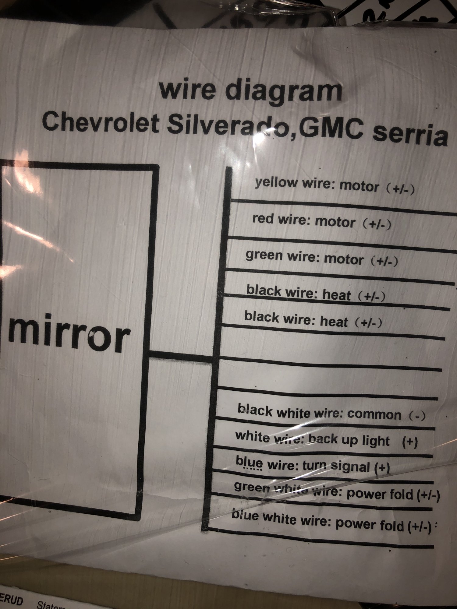

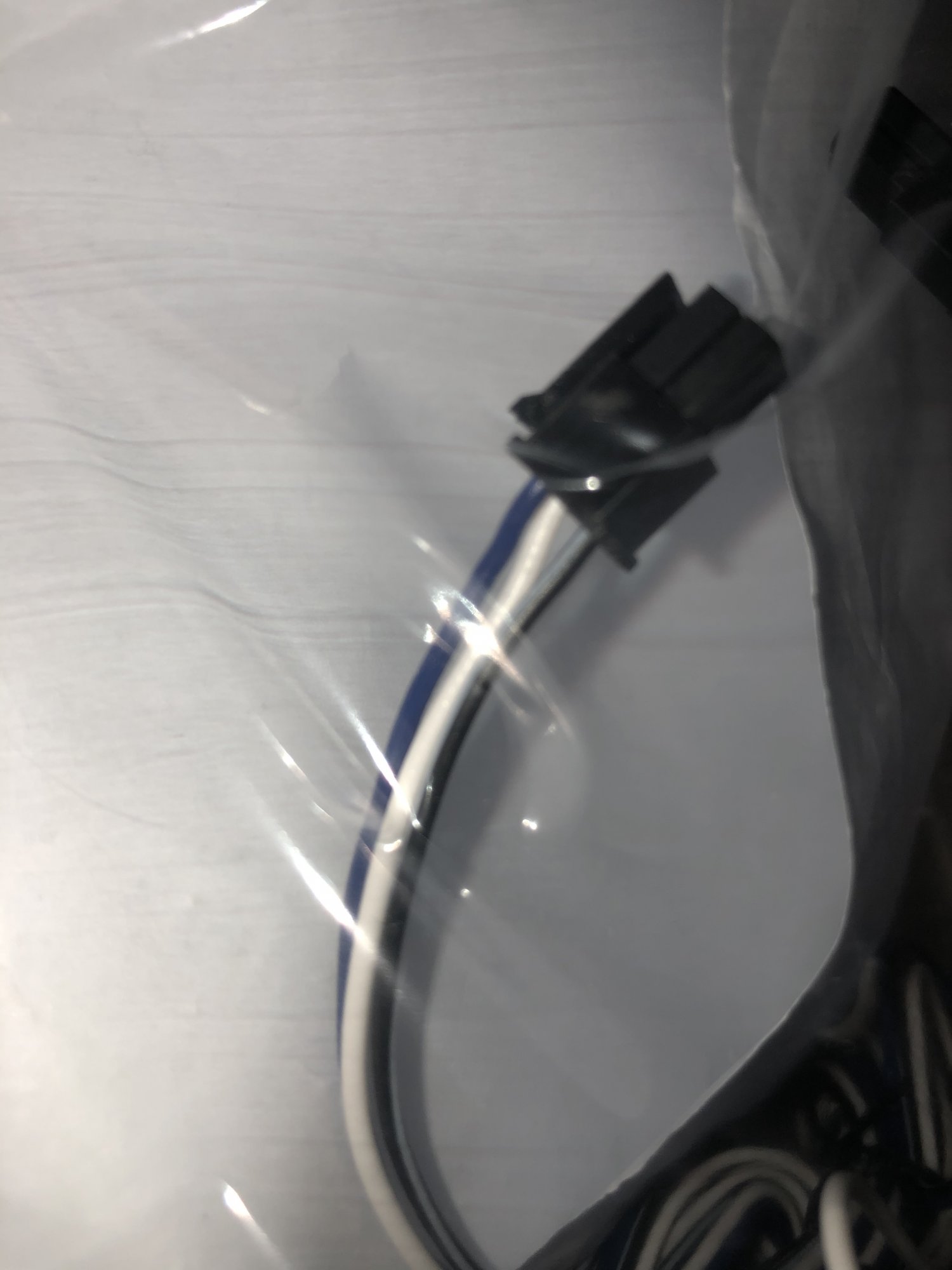

Hey all! I appreciate the tremendous amount of information that you all share here.
I have a question on a tow mirror upgrade from the DL3 mirrors on my 2014 Silverado 1500 LTZ.
The tow mirrors I purchased through American truck - https://www.americantrucks.com/silverado1500-powered-heated-tow-mirrors-smoked-led-turn-signals-black-rmx-siv14g3g-at-fs.html - are plug and play minus the back up lights (which I would like to pin the existing tow mirror plug to pull power from my existing puddle lamp power supply) and utilizing the blinkers as park lamps/running lights.
The harness off of the Tow mirrors came with 3 unpinned wires and according to their diagram they are as follows...
1. Blue - Blinkers
2. White - Backup
3. Black w/ White stripe - (common -) I’m assuming ground for the backup lights.
What I want to know, is can I pin the tow mirror plug with the white wire to utilize the existing power supply from the puddle lamps that were in my DL3 mirrors.
Secondly,
Is the unpinned blue “blinker wire” on the new tow mirrors supposed to be used for running the blinkers as park lamps/running lights. The blinkers on the tow mirrors already work from the factory DL3 harness, but I want them to work as running lights without creating any electrical issues.
I can pin a plug, but I don’t know what kind of power I will get from the puddle lamp. it seems awful dim for what I’m assuming the backup lamps will require. What I do know is that I want them to come on as a courtesy light when I unlock the pickup.
I’ve also seen that I can pin the x500 connector to achieve what I’m trying to achieve.
If anyone has any advice, please feel free to share. I can pin plugs, I just don’t want to interfere with the current function of the blinkers or short anything out.
A pin diagram of the x500 plug and the existing LTZ “door to mirror” plug would be great!
if I can just pin the new tow mirror plug that would be great! I have a feeling it won’t be that easy though!
Not only do I want it to work correctly, but I want to utilize all factory plugs of possible. If this requires adding things to the x500 connector that’s fine. Just looking for a clear explanation to achieve a clean factory quality install.
Thanks for any help!
Chris
