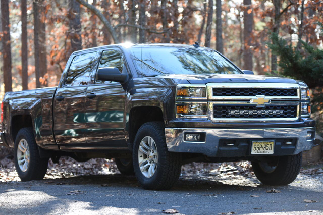

I just got a 5.3 15' CC 2wd 3.08. Orig tires were 255/70/17 I put on 33" terragrap g2's @ 285/70/17 (32.7"). 2.5 front Level and hypertech speedo recalibration.
driving from orange county, ca to vegas and going up steep hills like cajole pass didn't seem a problem. Definitely sluggish but I'm cruising a steady 70-75 uphill and has room to accelerate. Tranny temp usually around 187, but at extended hills (20+ miles with 9-10mpg) highest I saw climb to 199.
I'm getting around 16 mpg city and 19-20ish highway. V4 kicks in surprisingly more than I'd think .
