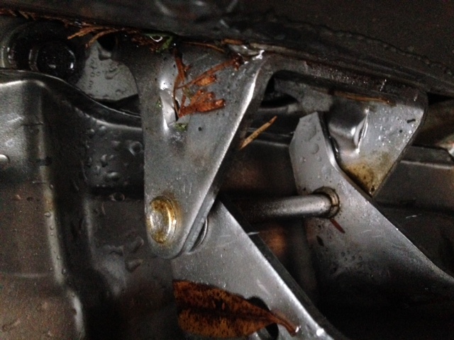

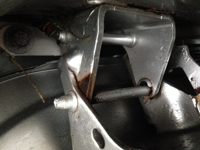

...not looking too good, but seems to be a known issue for the S10 / Blazer.
One option would be to use a 'oversized' bushing & pin set.
Another option to weld and drill.
Does anyone know how much the second option would cost?
Thanks.
