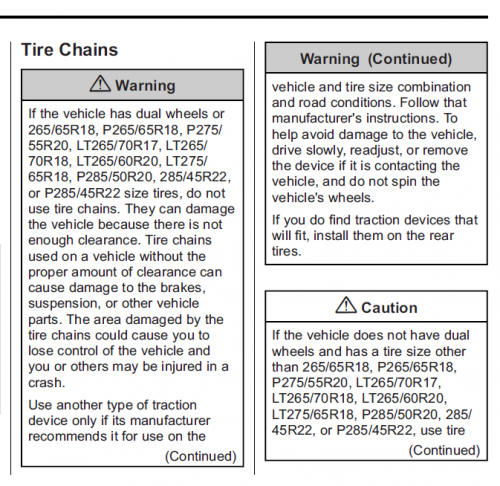

I have a 2015 Silverado LT 4X with 22" customs wheels - P285/45R22 Bridgestone A/T Duelers - Wondering if anyone knows of any issues with using a good tire chain ( cable ) in regards to the chains/cables messing up the wheels ( rubbing scratching)? i never have had to use chains on any 4X with A/T tires, but always have a pair with me.Thanks for any help advise.

From the GMC manual
