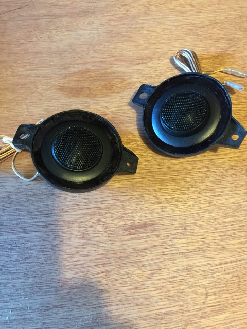

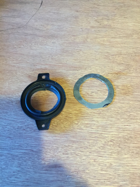

Should have done this sooner, dramatic difference. System now consists of Alpine 445U (45x4) compact amp pushing Alpine SPR-69 front doors, Alpine SPS-610C components (woofer in rear door, tweeter in dash). In retrospect I could have went with the Type R components, just wasn't sure how much room there would be to fit the crossover in the dash speaker area, as it turns out, inline HPF with the S series is rather large anyway. Simple mod to the stock speakers to use these as tweeter mounts. Chuck the speaker in a vise via the magnet and cut off the flange with a hacksaw. Trimmed the speaker cone and made a spacer ring from sheet metal. Thought I took a pic of the spacer after it was trimmed up nice and neat, apparently not. No big deal, once it was assembled, just hit it with a black Sharpie to color it in. Sound quality is great. Added bonus, door chimes are greatly reduced, make that significantly reduced.
