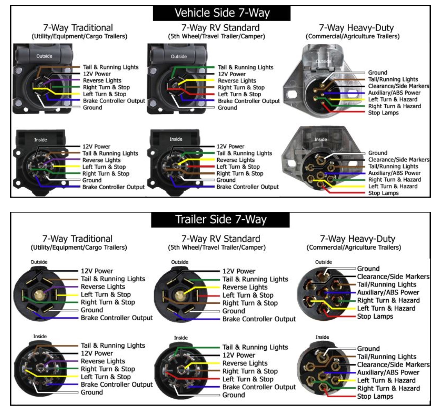

i have a 2015 Silverado and im trying to figure out how to wiring it safely and professionally. I need a left blinker, right blinker, brake lights, running lights, reverse lights and a ground. I know it has to be in the trailer harness but i can not find info on it.
ok i got it, I dont know if i posted this in the wrong spot or what. but the wiring i ended up going to the dealership and getting the info and talking with a tech, you need to wire it to the trailer control modular in the rear of the truck, in the the back side of the plug. but i cant remeber the colors i threw the paper away and im still on meds from getting teeth pulled
Perhaps these will help...but I'd wait until the Meds wear off...although your next post could be very interesting...?
