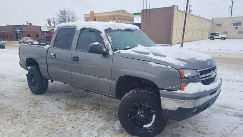

2007 Chevrolet 1/2 ton 4 door Stuck in Second Gear
118K miles, 5.3 Automatic.
It is "stuck" in second. It wont go into any other gear.
Shift range all seems appropriate
I just bought the truck, I have no history on it.
It does have a lift kit & larger tires installed. It looks like they are pretty new.
Anything I can do to check it out myself before I have to head to the dealer?
