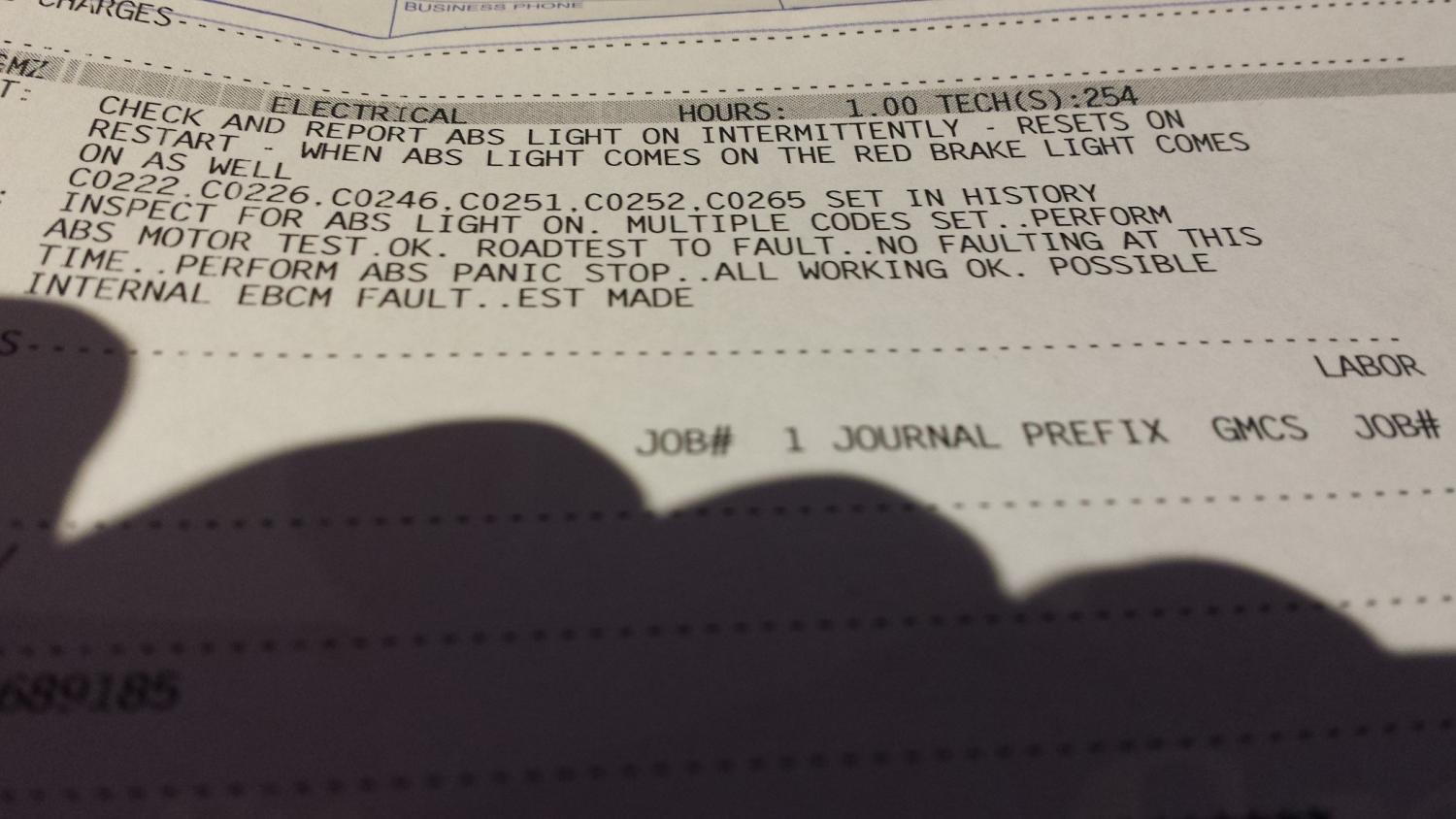

Heys guys short and sweet my 2001 Sierra Started showing the ABS and Parking Brake lights on the dash simultaneously once you turn off truck with key and turn it back on they are gone but I went to go scan for codes here is what I got is this the EBCM that is doing this? Here is the screen shot take a look and let me know Thanks guys
I have the same problem (read my own code as well). My codes were intermittent and all over the place, but I believe my root cause to be a loose relay on the ECBM. When the weather cools down I intend to pop it off and take a look inside.
Pretty common on the 800 series. Google search on the subject. Tons of info. Many cases have been broken solder joins in the EBCM. You can have them rebuilt fairly inexpensively and quickly
remove the EBCM, contact Module Masters (google them), send yours to them to get it rebuilt, and get a better one with a 5 year warranty sent to you, if you live in the rust belt, good luck getting the EBCM off, it is no fun..
I had them do my module last year.
100% agree that the removal process is no picnic. My job resulted in new brake lines through out the truck due to corrosion.
With mine, I first tried to just remove the ebcm from the valve block without removing it from the truck. I could not get the torx bolts out due to corrosion and the lack of room to get at them with sufficient leverage.
Upon attempting to pull the whole assembly, I found that the valve block and the brake line fittings had fused and corroded quite badly. Line wrenches were useless. I ended up cutting the brake lines and using a quality six point socket, liberal amounts of Kroil and a lot of colorful language.
You may be in a better place than I am. My truck has spent it's entire life in Michigan and northern Ohio.
Plan on having to remove the whole ABS module to get the screws out, unfortunately...
