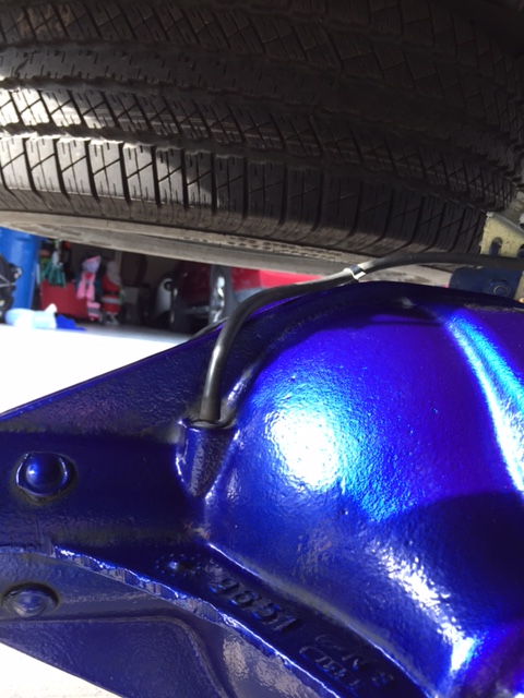

So I was cleaning the truck this weekend and noticed the vent hose to the rear axle has been severed. The severed end is up close to the front side of the gas tank.
What does this hose do & what issues is this going to cause?

The end of the hose has no connection, it allows the axle to breathe and is up high to stop fluid from coming out and water possibly getting in.
Back in the day GM used to put a small breather cap on those lines. As said all it dose is allow the diff to be able to vent pressure to the outside atmosphere.
