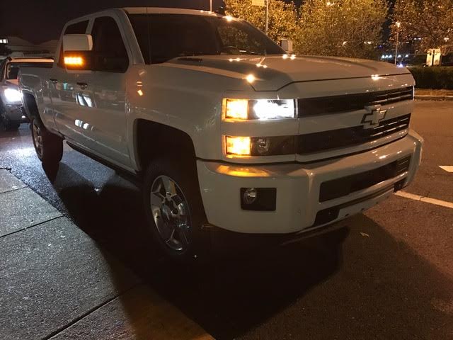

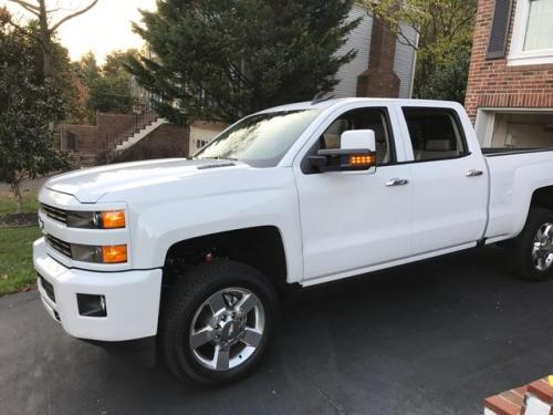

So I have already debadged and removed the side trim, but I was never a fan of chrome so decided to start working towards removing it. I painted my tow mirror caps white, window trim pieces black, and the front chrome grille inserts black. The door handles I am ordering in white and will be here soon. I also added black Duramax letters instead of the chrome.
Still would love to remove the orange in the head lights and tow mirror lights, maybe one day will get around to it.
Next will be wheels and tires!

looks good
What did you use to paint over chrome? Mind posting a quick step-by-step? TIA.
I used Kyrlon Maxx I believe it was? I can check once home.
Pulling off the whole front end just required four 10mm bolts on top (after removing the plastic tray).
Then there are 20 t15 or t20 screws holding in all of the inserts.
I removed those, scuffed up the inserts with sand paper, cleaned off any loose shavings, and then applied 3 coats.
Mirrors look good. I bought some vinyl tint and applied to my tow mirror lights, was pretty easy to do with a heat gun and I think it looks good. They look black during the day. Just an idea to get rid of the amber.
