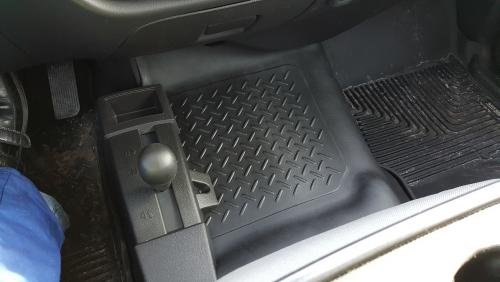

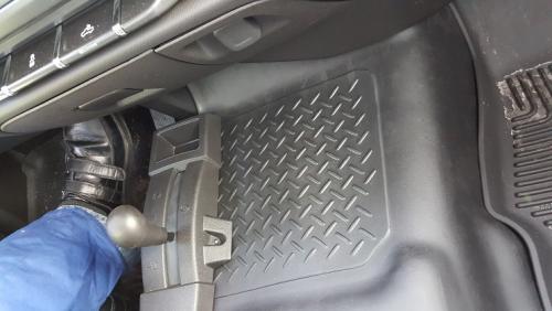

I have been trying to find a center mat that would fit my 2016 Silverado 1500 4X4 Custom with manual floor shift.
I couldn't find anyone that made one to fit this application so after a discussion with Husky and having a look at their flexible center mat for auto 4X4 shift I decided to give it a try by custom fitting the mat.
After having cut out a path for the shifter knob and after drilling the holes for the shifter cover through the mat it fit like a glove. The existing housing cover bolts are long enough to snug up the cover to the mat.
Here is the finished product installad
