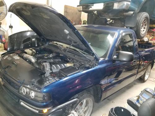

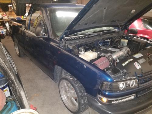

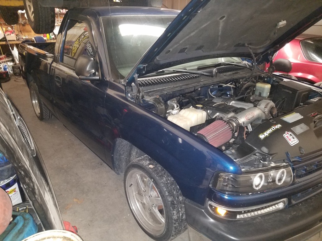

Thanks man...appriciated....it came out great... I'm a mechanic by trade and have my own shop...been doing this stuff since I was a little guy.. but this was my first ls swap...I'm a old school carbed guy...

One thing I wanted to touch on as well was the timing setup on the fast ecm as I forgot to mention this part of the build...when going through the ecm setup wizard it will ask you to verify a locked out timing setting of 20 degrees...in other words the ecm will dead lock out at 20 degrees it then needs to verify through you that it shows a balancer Mark of 20.... this was an issue as the ls2 has no timing tab because it's strictly ecm controlled with predetermined data...
Now what I did and you have to do is make a clear reference Mark on the timing cover somewhere you can see clearly with a timing light... then a piston stop will be needed to determine true tdc....basically your marking the balancer to match your reference mark on the timing cover at one side of the piston dwell...then roll the motor the other way until your at your piston stop again...this will be the other side of piston dwell...again Mark the balancer to match your timing cover reference mark....now you need to measure the distance between the two marks on the balancer and Mark dead center between the two marks....this is your true top dead center... and this Mark will be used to time the engine... use brake clean and erase the two original marks you made on the balancer..
Now you can advance your timing light to 20 degrees and bring the timing of the engine to the locked position of 20 the fast ecm is looking for... the handheld will show a value with - and + timing increments of .5... which ever button rolls your Mark to your reference point on the timing cover is the way you need to go...there is no solid answer on which way you will need but you will see it quickly...

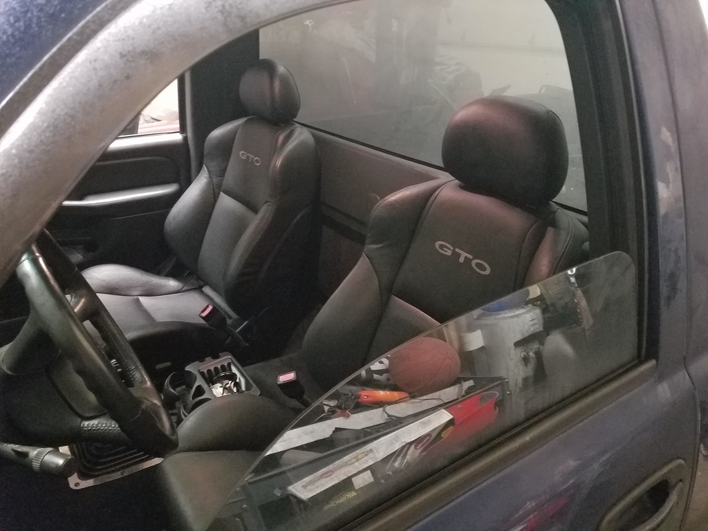

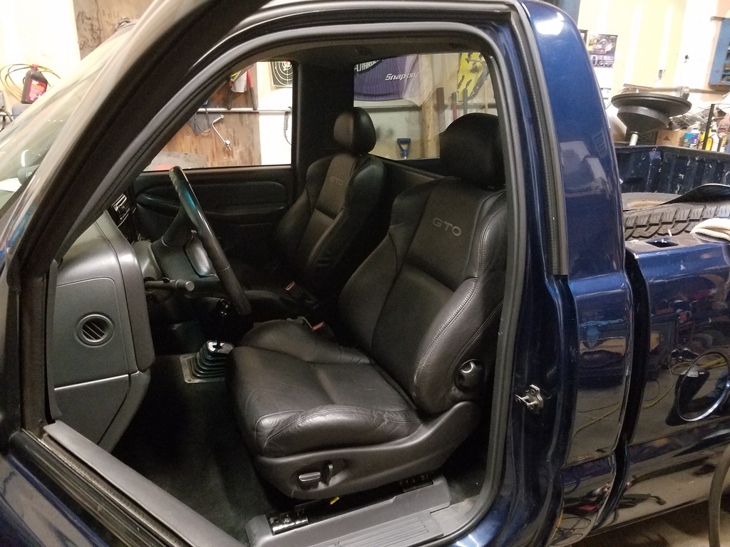

Well finally got the seats in and the harness made / installed for the gto power seats... this truck had no power anything so a circuit had to be made... I took the mounting tabs off the silverado seats...they are riveted and one is held on with nuts... then proceeded to cut the rivets and welds on the gto seats to get those brackets off...outer rear bolts on each seat needed the hole in the floor drilled out and a nut welded inside the bracket to allow the bolt To be put in from the bottom... all the silverado brackets were bolted back to the floor...gto seats were positioned and tacked... then removed to be welded fully...the Srs module had to be moved to behind the seat under the carpet...studs had to be fabricated to hold it in place...the low floor clearance of the gto seat wouldn't allow full movement front to back with the module in the factory location...this is only an issue on the driver side...passenger side is very straight forward... the harness is a simple + - circuit...ground was established next to the Srs module via stud on the floor under the driver seat... then hot was pulled from a vacant spot in the interior fuse panel...fused of course with a 25 amp mini...the plugs on the seat were changed to gm weather tight connectors as well as the harness i made...the adjustability is amazing on these seats...they also look amazing in this truck...
