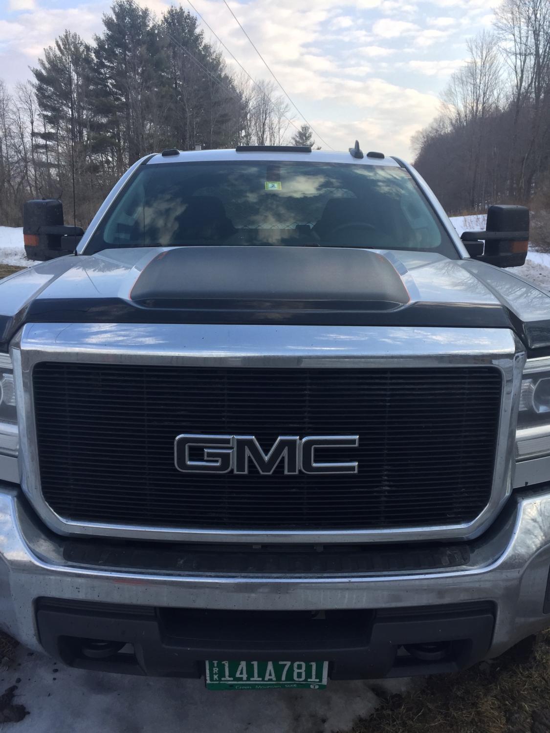

Put in the new trex grill insert, and wasn't easy to do it lot of test fitting and cutting of the old grill but it looks great and very well made!
Looks great. How about the bumper grille? I've been looking at the one that matches your grille.
Yeah I thought about it but I'm going to put the 17 inch light bar in that spot

I think this looks good, this would be a good contrast to white. Do you need to wreck the OEM grill? I would like to have it as a back-up. Do they make this in chrome or aluminium (natural). Something to add to the list
Yeah, you need to use an angle grinder to cut out the old grill from the frame so it's pretty much toast. I also put the lower grille in, which I did after installing the main grille. Suggest if you are going to do the lower that you install it while you have the main grille out as it's really a PITA to get to the bolts from behind the bumper. Here's a pic.
