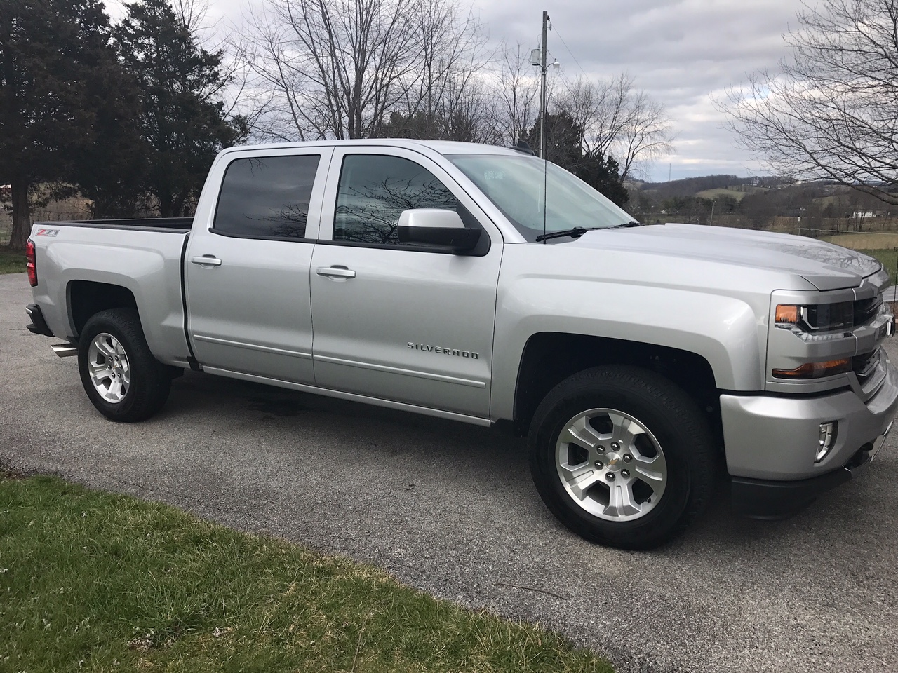

Pics or it never happened lol
I need to get a few taken, hope the weather is nice tomorrow and I will dig out my camera.
Just a quick pic.
Just a quick pic.
beautiful! looks like a good purchase to me!
