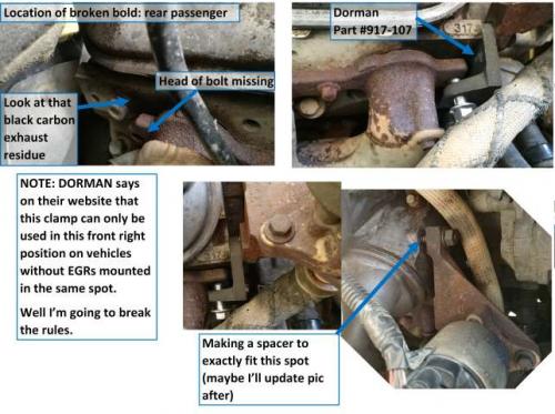

I made this post to show pictures of how to quickly fix an exhaust manifold leak without having to deal with the broken exhaust manifold bolts.

Notes:
Part #917-107 installation on passenger side front conflicts with EGR mount. On the DORMAN website it says this clamp does not work for vechiles with EGR mounted here, but I think it could...You just have to find some longer mounting bolts (of the right grade metal ("10 9" on bolt head I think)) and a spacer/bushing to fill the gap seen in image.
Testing it out once I get my new spark plugs in the mail. =-)
Part #917-142 installation on passenger side rear conflicts with dip stick. Be careful when installing clamp not to snap off your rusty dip stick. I didn't snap mine, but I have read many stories of other people having this dip stick break due to rust.
