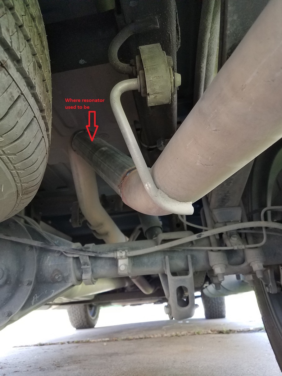

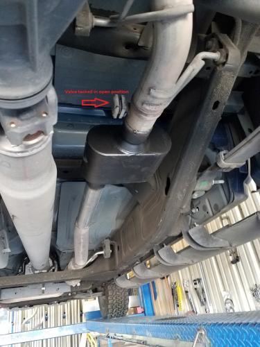

Did you leave the valve and resonator in place? Those two could be muffling the sound a bit, it did on mine anyways when I swapped just the muffler. I went with the Flowmaster super 10, had them just swap mufflers and it still sounded pretty much stock unless you really opened up on the gas. So I had them tack the valve open and remove the resonator, now it sounds great!!
