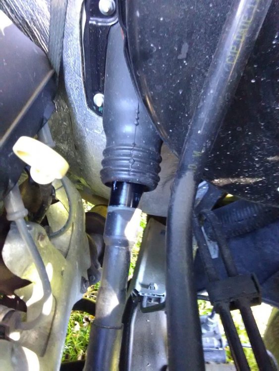

Installing a Zone Offroad 1.5" body lift on a 2016 Sierra.

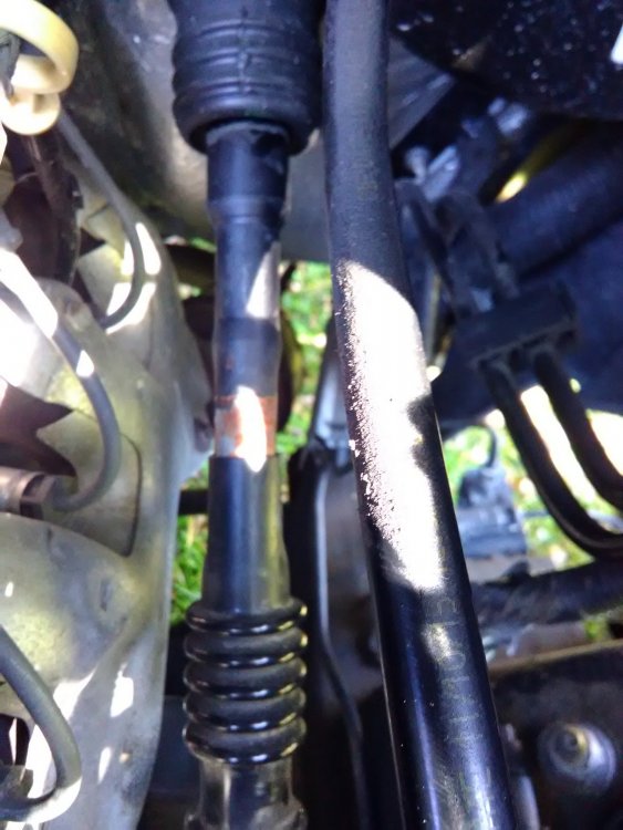

Take a look at the picture....that black paint is how far the steering shaft pulled out of the firewall. Is this safe to even drive?
(yes i took the bolt out below it hoping it would slide there)

Still think I am going to cut ....lengthen.....and weld that steering crush tube so it fits together correctly.
