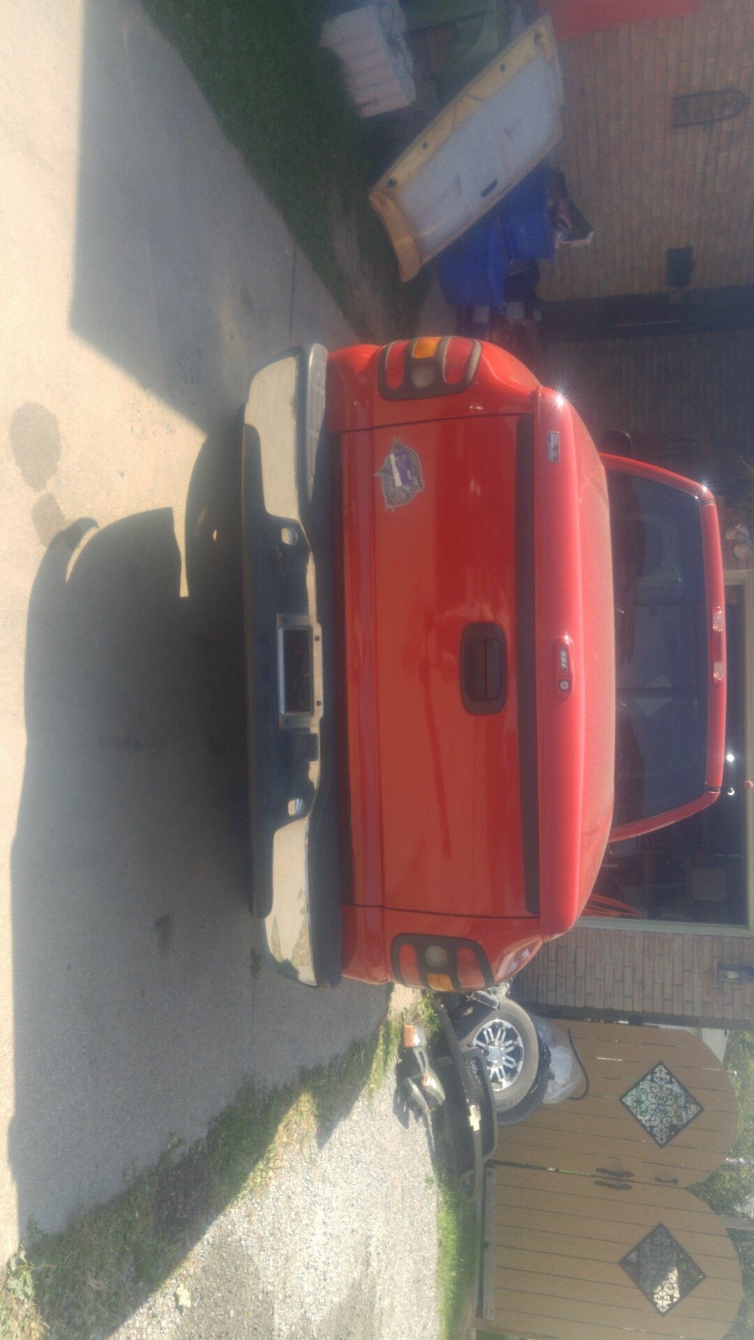

Just have a couple of questions, im looking to swap my 99 4.3liter to a 5.7l vortec, now because i live in southern ontario my truck needs an etest every 2 years. They plug their bullshit computer into the obd2 on anything 98 and newer and see if all the monitors are ready and there is no engine light on. Now i know they put obd2 into vehicles in 96, i believe, but i was just wondering if i could get a 5.7l vortec from 96-98 and have it work with my 99 computer. If all the sensors and everything will plug into a motor older then 98. Etests are bullshit, i dont know if anyone would be able to help me with that question but its worth a shot, thanks, im also looking at making it a 383 stroker and am unsure if thats even possible with fuel injected motors,
