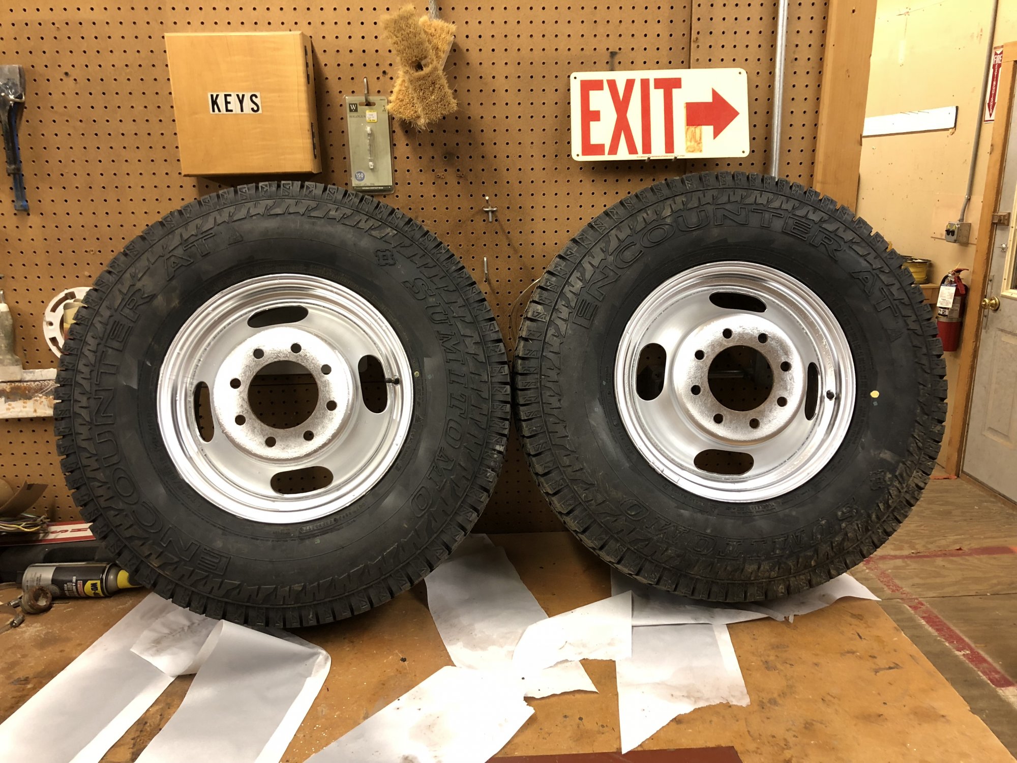

I also removed the two worst tires, which for some reason were the duals on the passenger rear. I removed them and installed two brand new Sumitomo Encounter A/T tires in 10-ply E-range. However, what I'm doing is installing the new tires on the front, and the original, good condition front tires to the rear. Since the rims will now be reversed to fit on the front, they looked like crap. I used an engine degreaser on them first, then power washed them, dried them, taped them off, and put 5 coats of silver wheel paint on them. They look much better.

Here's a pic of the re-painted rims:
