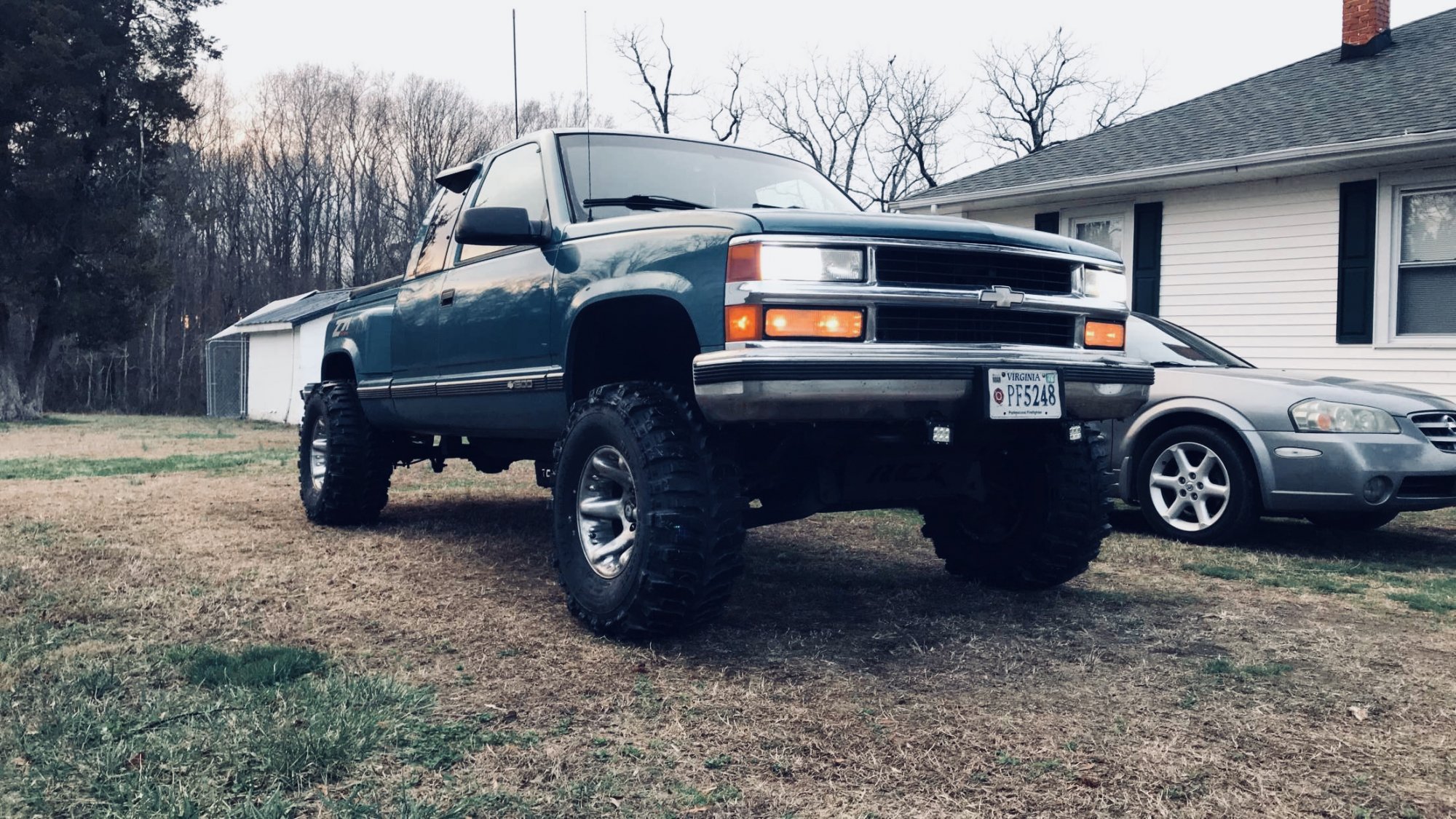

I have a 1997 k1500 that had a terrible O/D shudder. Replaced torque converter and did a filter and fluid change as well. Now about a month later it is coming back slowly but surely. Shouldn't be a miss but anything is possible. Doesn't happen when running 70 on interstate only at about 45 mph or 1200-1300 rpm
New long block 350 with 4,000 miles but with original intake system
Jasper transmission with roughly 60k on it
New distributor
New coil
New plugs
New wires
Any suggestions would be greatly appreciated
